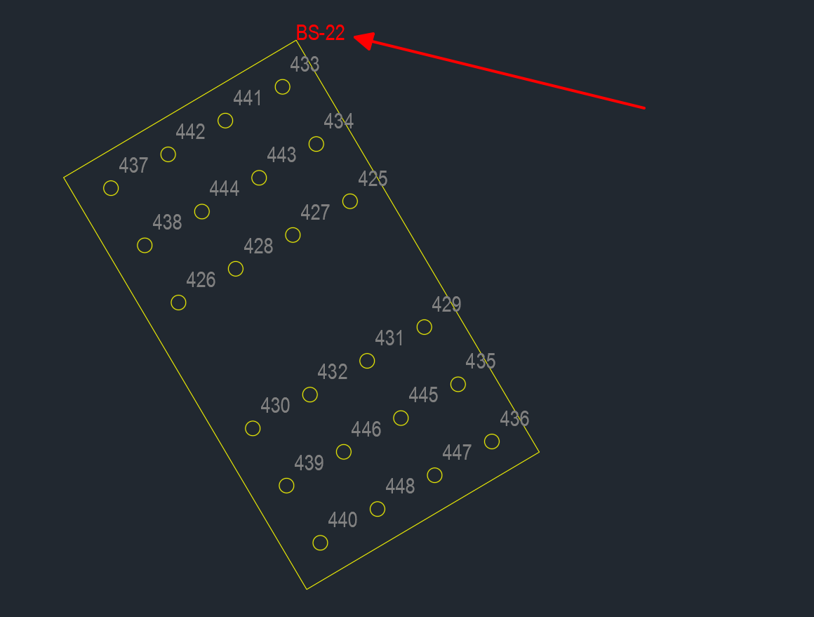

+ The circles are numbered in ascending order, can be from left to right or from top to bottom. (or maybe not). Just the circle number is numbered in ascending order and continues with the next rectangle.

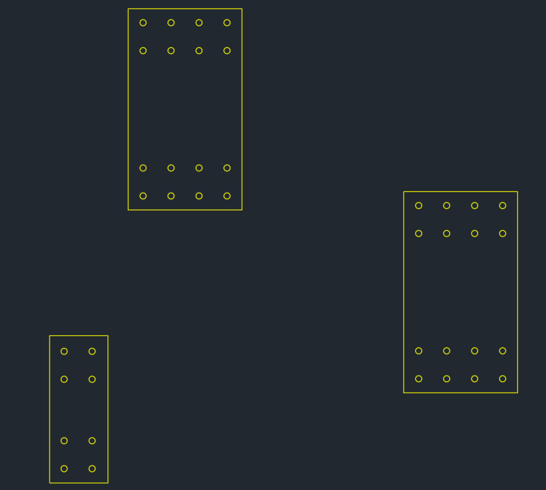

+ There is only 1 rectangle with no shapes inside or outside. The shape is a polyline
+ I have to do this every week, with a frequency of 10 times / weekanchor bolt plan.dwg
+ The number of circles and squares is very large, if I scan through each shape, it will take time

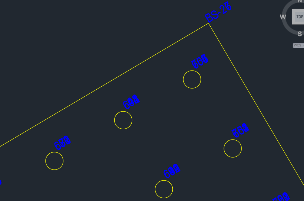

@BIGAL Thank you very much. But this is not the lisp I want.
I have the data is bolt positioning. What I need to do is number it to identify, then export the bolt center coordinate data to txt or excel file.
Anyway thank you.

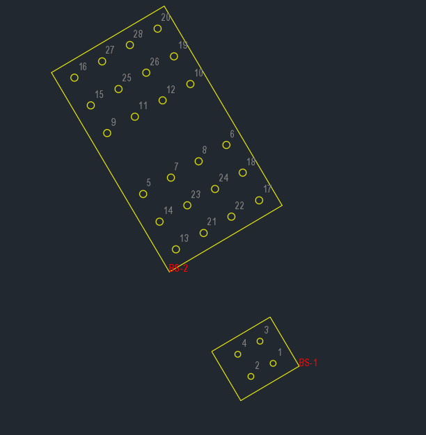

Try this

Pick lower left when asked. Used to get orientation, last number is saved in dwg.
In the "LST" is the co-ordinates of the circles. A question the example dwg does not look like a real size was this done just for get code ? How is the co-ords relevant to what ? Does not look like 0,0 etc.

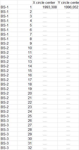

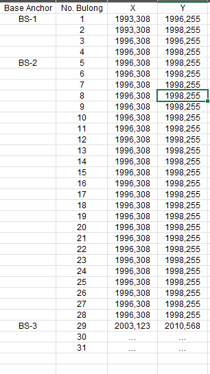

@BIGALThank you very much. This is the resulting excel file that I want.
It includes 4 columns.
Column 1 is the name of the rectangle / Column 2 is the circle number (inside the rectangle) / X coordinate of the center of the circle / Y coordinate of the center of the circle (coordinates relative to the origin 0,0. Take the decimal part of 3 numbers)
anchor_bolt.xlsx
I understand just have to have time to do something. I have to change the code to recognise the plines and look inside for circles this way the rectangs will be labelled in sequence.

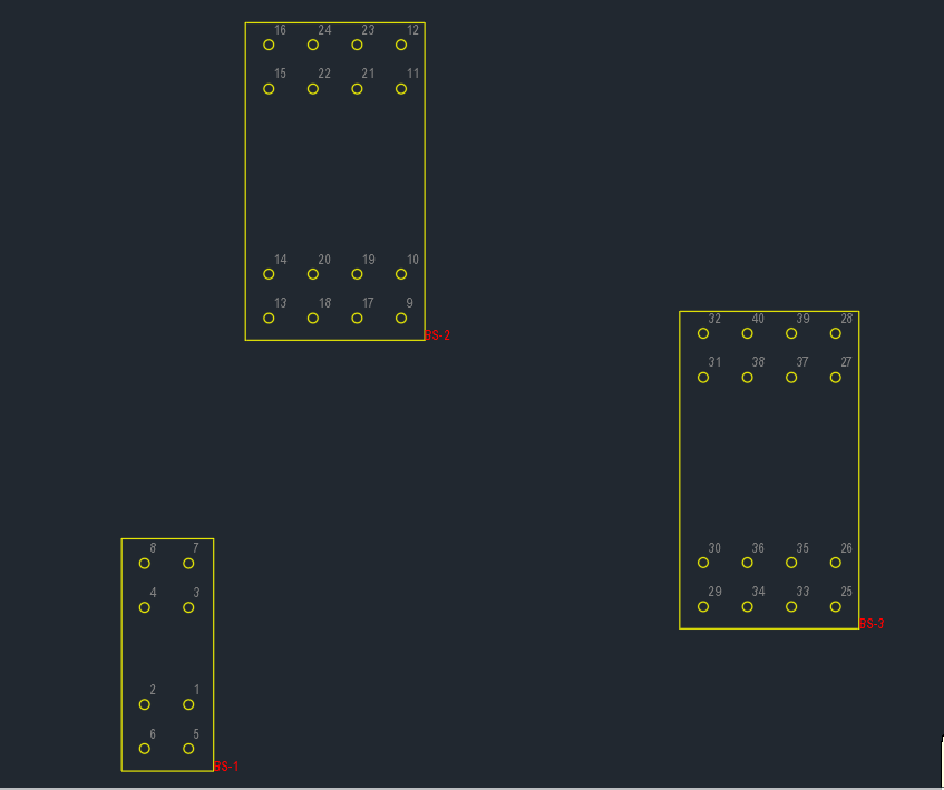

This is an update still a few bugs but sorts the rectangs now when selecting all. Missing llabelling 1st box not sure why not.
Once current bugs fixed will do the out to Excel that is the easy bit.

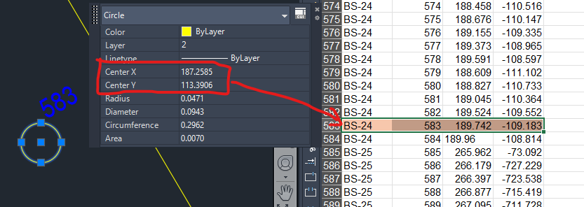

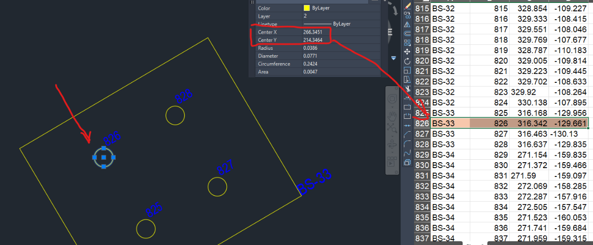

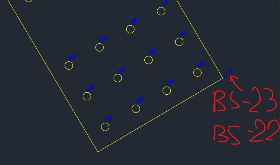

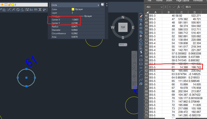

Thanks brother @BIGAL. Filling in the order number for the circle is ok. But I need more than exporting the coordinates of the circle corresponding to the rectangle to an excel file. I'm sure you are very busy. But please help me because it helps me a lot. Thank you.
Code above updated, do not have Excel open as code will open Excel. It is still under development but post any comments.

Thanks bro. The excel file has been exported. But the coordinates are incorrect.
Currently the exported coordinates are the coordinates after changing the UCS coordinate axis, not the coordinates compared to the origin 0,0 of the original drawing.
1. Duplicate - a rectangle is scanned twice
2. The coordinates of the circle relative to the 0,0 coordinates of the drawing are incorrect.
I hope you can fix this error soon.
Thank you.
Ok will look into why X&Y are wrong.
The duplicate did you run the code twice or pick the rectang twice ?
sorry, my file has duplicate rectangle.
please help me check the X,Y coordinates.
thank you very much.
