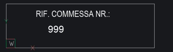

In my drawings I use a diesel expression to extract from the filename, only the final part that contains the client code.
Now I made a better version of it, but I don't know how to replace it quickly in my drawings, using a lisp.
I use:
$(substr,$(getvar,dwgname),$(-,$(strlen,$(getvar,dwgname)),9),6)
"Name of customer_24-999.dwg"    ->    24-999   <--- OK
"Name of customer_24-1000.dwg"    ->    4-1000   <---- Error
I solved it with:
$(if,$(substr,$(getvar,dwgname),$(-,$(strlen,$(getvar,dwgname)),7),1)"1",$(substr,$(getvar,dwgname),$(-,$(strlen,$(getvar,dwgname)),10),7),$(substr,$(getvar,dwgname),$(-,$(strlen,$(getvar,dwgname)),9),6))
"Name of customer_24-1000.dwg"    ->    24-1000  <--- OK
If I try to extract DXF data I only get the text string (24-999) not the Diesel expression that creates it!
Prova. 24-999.dwg Prova. 24-1000.dwg

I used the word "DXF" incorrectly... Actually I just wanted to say that if I do (Entsel) on the text that contains a data field, I find "24-999", I don't find the diesel string of the field $(substr,$(getvar,dwgname),$(-,$....
On 12/6/2024 at 3:20 PM, pkenewell said:
@BIGAL You can't use regular AutoLISP expression in a FIELD. I think the OP wants something that will automatically populate based on the name of the drawing file, say in the title block. That being said:
@X11start Does this value become static once the drawing is named? If so, you could use a start-up AutoLISP routine to look for the text or attribute you want to populate, then fill in the correct value. You don't necessarily need a FIELD. The start-up routine could also re-fill the string if the drawing name is changed at the next time it is opened, or in real-time with a reactor.
@pkenewell you have centered my request: the data field remains fixed as soon as I assign the name to the file: try to rename one of the 2 DWGs I have attached. Interesting your idea of putting a lisp in the startup to make it edit the text!
Thank you all for the answers and for your availability!
For obtain field code, you can use this:
(vla-fieldcode (vlax-ename->vla-object (car (entsel))))
For put field code in existing text, for exemple you can do this:

Thank you all for your interest: I solved with @Tsuky's suggestion. I created a small lisp file with a single command:
(vlax-put(vlax-ename->vla-object (car (entsel)))'TextString"%<\\AcDiesel $(if,$(substr,$(getvar,dwgname),$(-,$(strlen,$(getvar,dwgname)),7),1)\"1\",$(substr,$(getvar,dwgname),$(-,$(strlen,$(getvar,dwgname)),10),7),$(substr,$(getvar,dwgname),$(-,$(strlen,$(getvar,dwgname)),9),6))>%")
If I open a drawing and see that the data field is wrong, I launch the lisp that copies the long diesel string, instead of the old one.
... much faster solution than going into each data field using DCL and copying the string!
