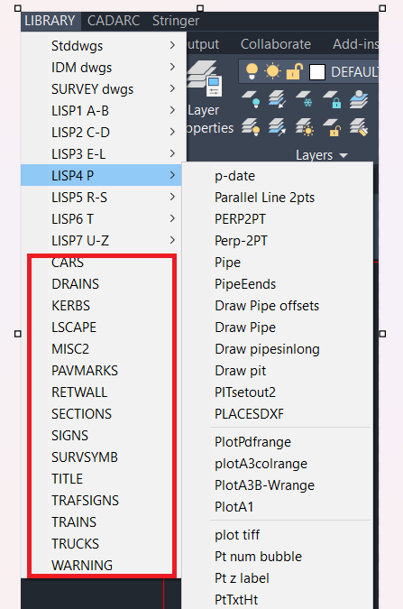

You can save as many dwg's as you want as say Symbols in your description, to anywhere you want on a drive, I would not save real deep, you should add the directory path to your support directory list. Options Files Support. We had all our blocks on a single server so only existed in one location. If blocks are in a support path you only need its name not path when inserting. We had a Blocks directory with sub directories. Around 120 dwg's.
