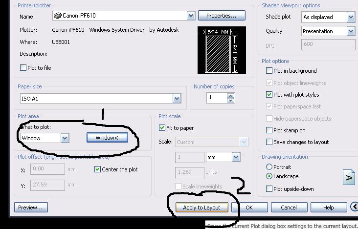

stevsmith Posted April 15, 2009 Posted April 15, 2009 Have you clicked on "apply to layout" before you print? After defining the window you need to click this to allow Autocad to remember. Quote
eldon Posted April 15, 2009 Posted April 15, 2009 Have you checked the box "Save changes to Layout" under Plot Options Quote
MikeP Posted April 15, 2009 Author Posted April 15, 2009 It does work when I click apply to layout, but ive never had to do that before. It wold always remember the last position Quote
stevsmith Posted April 15, 2009 Posted April 15, 2009 Glad to see that worked. If you import your title block, you then have to re-scale it to a size to suit the drawing. If you goto your plot settings and change the window select to extents. that way it prints everything within the titleblock. (as long as you dont have stuff floating outside it.) Thats the way I have mine set up. I dont use paperspace either. Quote
rkmcswain Posted April 15, 2009 Posted April 15, 2009 MikeP said: It does work when I click apply to layout... So I'm guessing that you don't use or have any named page setups. Page setup information (window location, page size, etc.) is stored on a per-layout basis in the drawing. If you are not saving it, then you can't expect it to be there when you go back. 1 Quote
