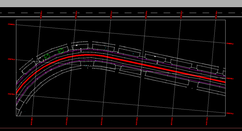

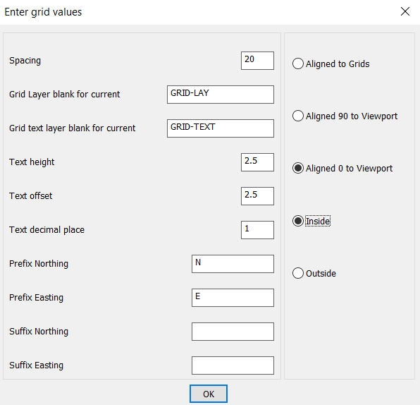

BIGAL Posted November 26, 2024 Posted November 26, 2024 (edited) This is my attempt at grids of a viewport. It will cost you a cup of coffee. Supports twisted views. Edited November 26, 2024 by BIGAL 1 Quote
