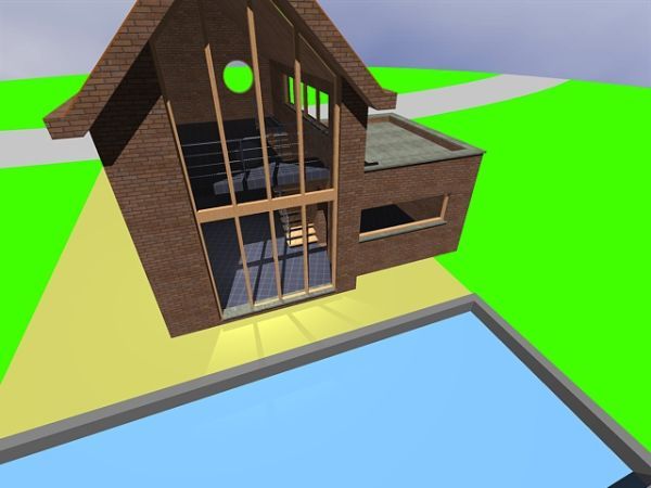

i allow have attached
a render picture how it looks now
-how do you apply more materials to the same object
like a wall: brick on one side and on the other a different one.
In the Material Editor, click the "Apply Material to Objects" button. Then hold down the Ctrl key while clicking on a single face of your model to apply the material to just that one face.
