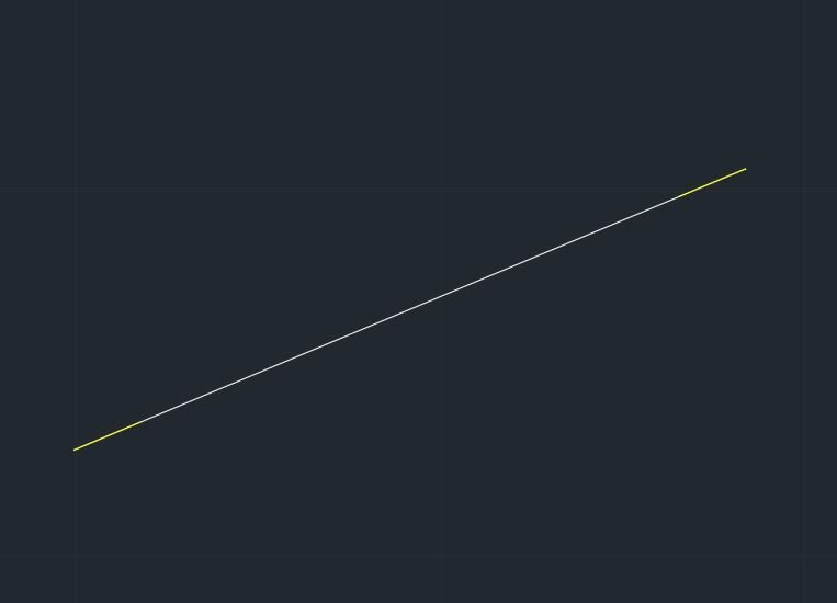

Need a lisp to draw a line (2mm length and yellow colored) from the end point of the selected line towards the other end point.

but if I finally want to delete the original line (the white line).
It will be better if the multi selection is enabled, so that we can select many lines and apply this lisp.

But the total length will not be extended.
the total length is required to be constant.
I mean, the yellow line will start from the end-point of the oldline towards the other end-point.
Edited by Mohamed_Essam_2000
Yes, in the original request I missed that "towards the other end point".
So... this can process more lines at a time.

@Mohamed_Essam_2000 just a comment in future for similar request it would be more helpful if you refer to the task as "from start point towards end point", this makes it clear which end to draw from, the reason I say this is often use select an end to determine the direction you want to draw in, this allows for swapping of line direction if needed.
As shown by @fuccaro the start point for a line  is dxf (cdr (assoc 10 line))  or VL (vlax-curve-getstartPoint obj) or (getpropertyvalue (car (entsel)) "startpoint")
