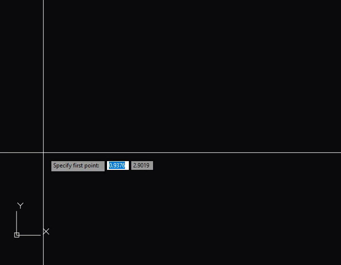

Here's a quick one to draw the line and add circles at the end:
(defun c:foo (/ _circle d p1 p2 r)
  ;; RJP » 2024-11-26
  (defun _circle (p r) (entmakex (list '(0 . "CIRCLE") (cons 10 p) (cons 40 r))))
  (cond	((and (setq p1 (getpoint "\nSpecify first point: "))
	      (setq p2 (getpoint p1 "\nSpecify next point: "))
	 (_circle p1 (setq r 0.75))
	 (_circle p2 r)
	 (entmakex (list '(0 . "LINE")
			 (cons 10 (polar p1 (angle p1 p2) (setq d (- (distance p1 p2) r))))
			 (cons 11 (polar p2 (angle p2 p1) d))
And one to select lines:
