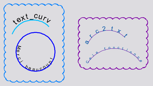

Lisp issues an error, how can this be fixed?
;  Larry Knott author
;  Draws center aligned text along an ARC.  The start point of the text
;  is the ENDpoint of the ARC closest the pick point.
;  Select arc: ; error: invalid argument type: point: nil

p1 (osnap (cadr e0) "_end")
I'v tried the "arc2txt" and it works well (see attached picture).
Try to load it in Visual Lisp IDE, select in card Debug -> Break On Error, then run LISP and see where the error occured. Also, there is a "Arc Aligned" function in "Express Tools" (if you have it in your version of CAD) or just type a ARCTEXT command which is better then posted LISP.

ARC2TXT.dwg
In ARC2TXT.dwg the LISP works well, i don't get an error (see attached picture). Do you have other examples (you said "on all drawings")? But according to the error I assumed that the problem is in (p1) when defining all the points for the each text value that is set to ARC, because there is no passed point value.

I haven't tried your code, but reading it I see that (command) is used but that the osmode variable is not managed.
This can create bad point feedback following the current snap.
Another note: I see that international mode is used, that's good.
But an oversight (on line 28): (osnap (cadr e0) "end")
put an underline in front of "_end" . If using a non-US version this may return a null point.
I have my own version for you if you want to try it.
Thank you for your attention! I will fix "_end" and add osmode...
Your text_curs.lsp program is wonderful, it has a lot more features  (*LINE,ARC,CIRCLE,ELLIPSE).
Thank you very much!  Merci beaucoup!
