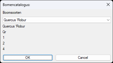

Hi @pkenewell, what i am looking for, is that the DCL shows the information from the CSV file. So our user can select a 'type of tree' from the list, and instantly sees the information.
For example, below the desired result, wich matches the same line of the CSV.
When i press 'OK', the data is set the a symbol and i can generate the blocks and layers i want.
But this 'preview' is not working as wanted...
Somehow, when i pick a value from the list, the 'labels' needs to be updated, without selecting the 'OK' button.
Edited the original post to include the CSV functions.

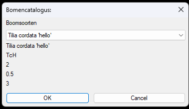

Solved it, thanks to @pkenewell
solution:
			(action_tile "tabellen_list" "(setq lret (atoi $value))
				(set_tile \"dynamic_label\" (nth lret (reverse boomsoorten)))
				(set_tile \"dynamic_label_2\" (nth lret (reverse boomafkorting)))
				(set_tile \"dynamic_label_3\" (nth lret (reverse boomgrootte)))
				(set_tile \"dynamic_label_4\" (nth lret (reverse boomdiametermin)))
				(set_tile \"dynamic_label_5\" (nth lret (reverse boomdiametermax)))
