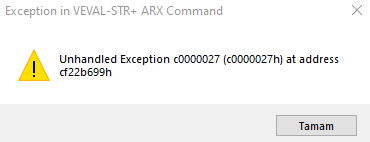

DeEng Posted November 18, 2024 Posted November 18, 2024 (edited) Hello everyone, I'm using AutoCAD 2022 and developing an AutoLISP application that involves reading data from a file and drawing lines based on this data. However, I'm encountering an error when trying to use the _LINE command to draw lines. The error message is as follows: Exception in VEVAL-STR+ ARX Command Unhandled Exception c0000027 (c0000027h) (setq x1 (atof (nth 0 values))) (setq y1 (atof (nth 1 values))) (setq x2 (atof (nth 2 values))) (setq y2 (atof (nth 3 values))) (if (and (numberp x1) (numberp y1) (numberp x2) (numberp y2)) (command "_LINE" (list x1 y1 0.0) (list x2 y2 0.0) "") ) What I've Tried: Checked that x1, y1, x2, and y2 are indeed numbers using numberp. Verified that the values are not nil before calling the command function. Added debug messages to print the values of x1, y1, x2, and y2. Despite these checks, I still get the error. Could it be an issue with the type conversion or the way the _LINE command is being called? Any insights or suggestions on how to resolve this issue would be greatly appreciated. AutoCAD Version: AutoCAD 2022 Edited November 18, 2024 by DeEng Quote

pkenewell Posted November 19, 2024 Posted November 19, 2024 (edited) @DeEng Ok - here are some thoughts: 1) It's very difficult to diagnose the problem if a) we don't have any way to run it, and 2) we don't understand the purpose. However - I can see the following: 2) The first obvious thing I see wrong with the code is this line: (action_tile "btn_exit" "(exit)") You should never use "exit" here as it stops all code processing and sends to the error handler, which doesn't allow the dialog to close or unload properly. It should rather be: (action_tile "btn_exit" "(done_dialog)") 3) The second obvious thing i see is that you MUST close the dialog before you run (command). You are trying to run the LINE command while the dialog is still open which is not allowed. You have to close the dialog before you can do the LINE command. Your defun (AnalyzeAdditionalLines) tries to run while the dialog is open, hence the main problem I think. I suggested changing: (action_tile "btn_open_model" "(open_model_file)") (action_tile "btn_open_card" "(open_card_file)") to this: (action_tile "btn_open_model" "(done_dialog)(open_model_file)") (action_tile "btn_open_card" "(done_dialog)(open_card_file)") Or you have to rearrange your function (AnalyzeAdditionalLines) to run after the dialog closes. You can use an argument (done_dialog n) with an integer that can be captured with (start_dialog), such as (setq retval (start_dialog )) and use a conditional statement example (cond ((= ret 1) (do_this1)) ((= ret 2) (do_this2)...) etc to do different things after the dialog closes, then optionally re-load the dialog after within a (while) loop such as (while (> ret 0) ....) Edited November 20, 2024 by pkenewell 1 Quote
DeEng Posted November 21, 2024 Author Posted November 21, 2024 Thanks for the help. After editing the main file like this, the program worked. (defun c:MAIN () (setvar "OSMODE" 0) (create-layers) (setq dcl_id (load_dialog "kart.dcl")) (if (not dcl_id) (alert "DCL file could not be loaded!") ) (if (new_dialog "main_dialog" dcl_id) (progn (action_tile "btn_info" "(setq userAction 1) (done_dialog 1)") (action_tile "btn_holes" "(setq userAction 2) (done_dialog 1)") (action_tile "btn_open_model" "(setq userAction 3) (done_dialog 1)") (action_tile "btn_open_card" "(setq userAction 4) (done_dialog 1)") (action_tile "btn_working_directory" "(setq userAction 5) (done_dialog 1)") (action_tile "btn_exit" "(setq userAction 0) (done_dialog 0)") (start_dialog) ) ) (unload_dialog dcl_id) (cond ((= userAction 1) (show_info_dialog)) ((= userAction 2) (show_holes_dialog)) ((= userAction 3) (open_model_file)) ((= userAction 4) (open_card_file)) ((= userAction 5) (select_working_directory)) ((= userAction 0) (exit)) (T (alert "No valid action selected.")) ) ) Quote
