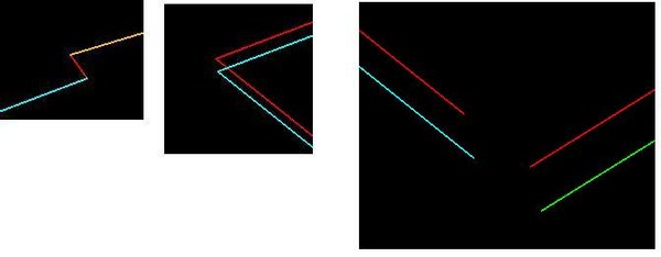

azman modular Posted December 14, 2007 Posted December 14, 2007 hi guys.. i'm using cad 2007 map 3d... how do i join line that not pararell? i'm using pedit but it's cant't be join.. pls help me to solve this problem.. tq Quote
PS_Port Posted December 14, 2007 Posted December 14, 2007 Azman , I'll take a guess.. Have you tried PEDIT then M (multiple) then JOIN then set the FUZZ fuzz is the gap it will assume lines not joined ... If not then maybe give us a screen shot to see what lines you mean. Quote
Guest Alan Cullen Posted December 14, 2007 Posted December 14, 2007 You can't join 3D polylines. You have to flatten them first. But then they won't be 3D anymore. Quote
azman modular Posted December 14, 2007 Author Posted December 14, 2007 hi. guys i try to join this line then i'll extrude. i did use multiple and then icon fuzz appear and need some distance. how? join line.pdf Quote
riga Posted December 14, 2007 Posted December 14, 2007 I think you can not join them. I'm not used to work on 3D but I've noticed that if your lines are 3D polylines PEDIT wont have the Join option. If they are 2D polylines then you wont be allowed to join them because they dont lay down entirely on the same plan. Not sure that's the reason, but it's what I can guess after a few attempts to reproduce your problem Quote
Cad64 Posted December 14, 2007 Posted December 14, 2007 That's exactly right riga. PEDIT only works on lines that lie in the same plane. If you want the lines joined then you should redraw your shape using the 3DPOLY command. But even then, you won't be able to EXTRUDE. Extrude only works on plannar objects. Quote

JD Mather Posted December 14, 2007 Posted December 14, 2007 i try to join this line then i'll extrude. I can't see where LOFT, THICKEN, or SLICE helps azman get his 3D polys to join. If azman modular intends to "extrude" this profile then a joined 3D poly is not going to get any closer to a solution. I haven't used Map 3D but I would be surprised if there isn't a command in that vertical to join a 3D poly as there was in the old Mechanical Desktop vertical. But again - that is not going to help in getting a 3D "extrusion". There is a link to learning 3D modeling in my signature. Quote
JD Mather Posted December 14, 2007 Posted December 14, 2007 You can't join 3D polylines. You have to flatten them first. But then they won't be 3D anymore. Looks to me from the picture that the design intent is a curved face - not a planar face. Now if the OP would simply attach the file instead of a picture.... Quote

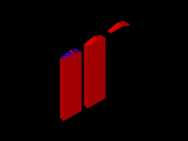

JD Mather Posted December 14, 2007 Posted December 14, 2007 This is how I interpreted the pdf. Drawing1.zip Quote
azman modular Posted December 15, 2007 Author Posted December 15, 2007 thanks guys for your support!! i'm building up temporary stucture and the drawing in PDF that i shown last time was drawing of roofsail.. 1'm already stuck with that for a month.. tq Quote
azman modular Posted December 15, 2007 Author Posted December 15, 2007 alan cullen,here the drawing......pls bro..is it possible to extrude it after u join them?roofsail.dwg Quote
Guest Alan Cullen Posted December 16, 2007 Posted December 16, 2007 Okay azman, Here is your drawing. I took it into 12D to join it. You'll have to reset your UCS back up again. roofsail-12D.dwg As for extruding or anything 3D related, you'll have to talk to a 3D guru there. I know nothing of 3D. Quote

scj Posted December 16, 2007 Posted December 16, 2007 Sorry my English is not so good, but I understand the problem in that way: 1. Make a surface of the bounding 3D-Polylines (in the attachement I used RULESURF with SURFTAB1 = 20) 2. Make a 3DSOLID from the SURFACE (I used M2S.lsp with a length of 50) 3. Make a copy of the 3DSOLID and get the difference (I took a thickness of 1) Next steps are to create the unfolding of the surface but this is another problem, which I can solve too... Regards Jochen Quote
JD Mather Posted December 16, 2007 Posted December 16, 2007 I just had a thought. You could draw a new 3D polyline over the old bits an pieces, then delete all the bits and pieces and be left with one full 3D poly. You would have to change the design intent or at least verify exactly what the design intent is/was as there are two gaps in the geometry supplied where endpoints do not meet. A decision needs to be made about what was intended to fill in the missing information. In a case like this I would not delete the bits and pieces but put them on a hidden layer in case it is necessary to go back and show how the original geoemtry had these gaps. Quote
JD Mather Posted December 16, 2007 Posted December 16, 2007 1. Make a surface of the bounding 3D-Polylines (in the attachement I used RULESURF with SURFTAB1 = 20) 2. Make a 3DSOLID from the SURFACE (I used M2S.lsp with a length of 50) 1. RULESURF is obsolete (not needed) in r2007 and later. 2. M2S.lsp not needed for this problem with r2007 and later. Quote
