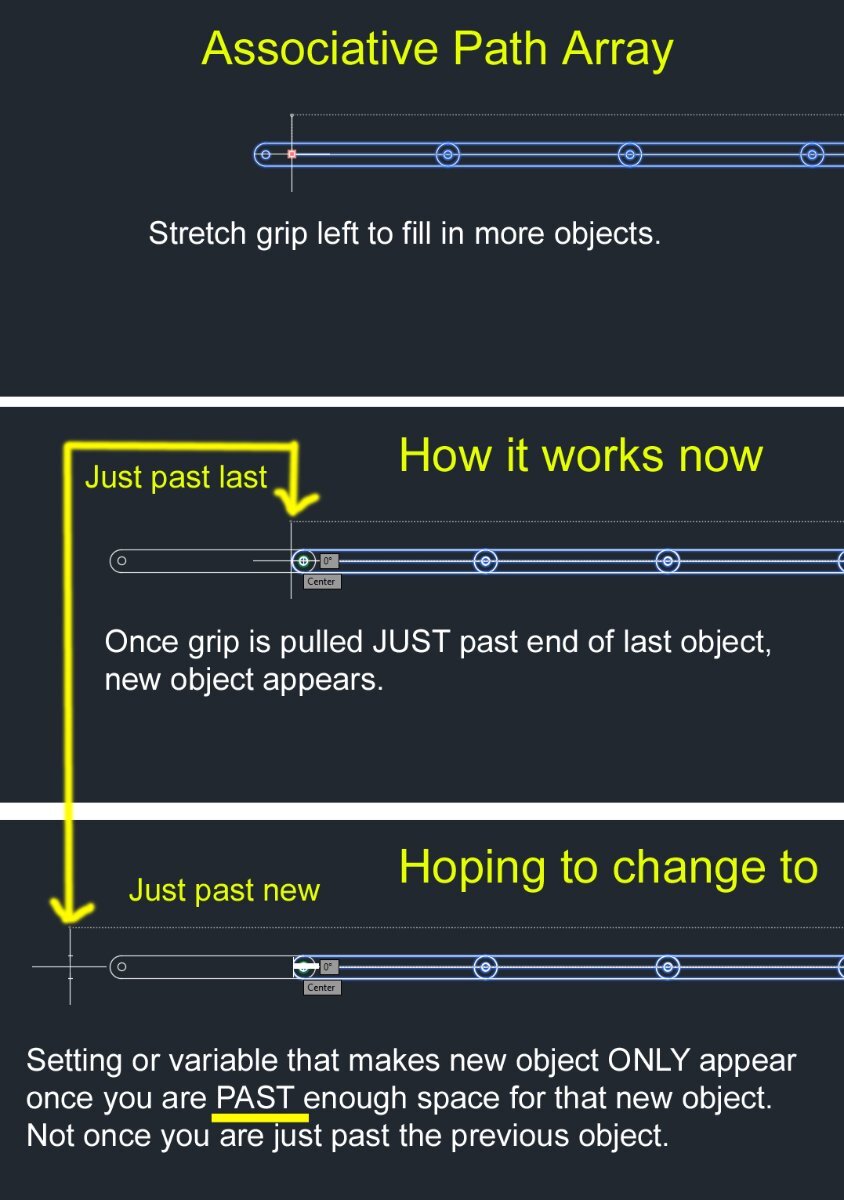

Associative path Array:
Im looking to see if any one knows of a setting or variable I can change for my Associative path Array.
- Right now, a new object will appear once i pull the grip JUST far enough past the last object. A new one will pop in.
- I am hoping to change something in the settings so that the new object ONLY appears after my grip is far enough in length to accept the new object.
Attached is a description in pictures to help illustrate...
Thanks for any feedback!
Have you looked the properties window and play with the 3 top lines in MISC, Method, Items and Item Spacing. You can get at all the properties of the array via lisp, but they are a bit buried. The other way is using a dynamic block but it has a fixed object. There are examples of array within a dynamic block. I can not help don't have any blocks like that. Some one else may have one. A sample in CIV3D is Carpark.dwgParking Tools - Imperial.dwg
