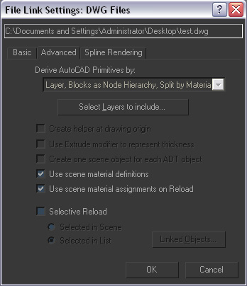

I create my drawings in ACAD using blocks then import to MAX or VIZ [depending on the comp].
I can link the files to MAX and apply materials as needed, but when I go back to ACAD and modify, then reload it in MAX all my materials are removed from my model..?
Is there some way of reloading in MAX that will keep the materials applied to my objects?

I take it you're using the File Link Manager to import your CAD file?
And then you are applying materials in Max, correct?
Then the problem arises when you reload your CAD file after modifying it?
If the above is true, then you just need to make a simple adjustment to your Reload options.
After modifying your CAD file, open the File Link Manager and click on the Files tab
Select the file you want to Reload
Make sure "Show Render Options" is checked
Click Reload
You should now be presented with the "File Link Settings" window
Click on the "Advanced" tab
Make sure "Use Scene Material Definitions" is checked
Make sure "Use Scene Material Assignments on Reload" is checked
Click Ok

I have just tried it with the settings as they are and it has regenerated the drawing in VIZ without resetting the materials applied!

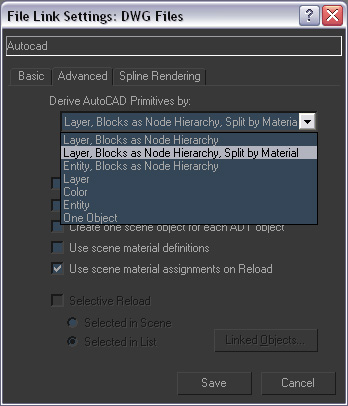

There is one other thing.......I normaly import ACAD into VIZ via the file / import and select AutoCAD (*.DWG) which brings in my block drawing separating every part within my blocks individually.
But when I import as FILE LINK it imports differenty, my blocks import as one making material appling a very long proccess. Is there a more efficiant way which will allow my blocks to import as all individual parts?
