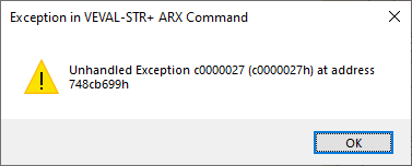

Hi all,
Here's the error I'm getting:
It's got to do with line 47 of the code below:
It's like commands are blocked when the rename button is clicked.
The renaming of the layers is okay and works.
To reproduce this bug, do the following:
If you have a block in a drawing, select it and the dialog will pop up. Select an item in the block list, enter a new name and that error above should appear.

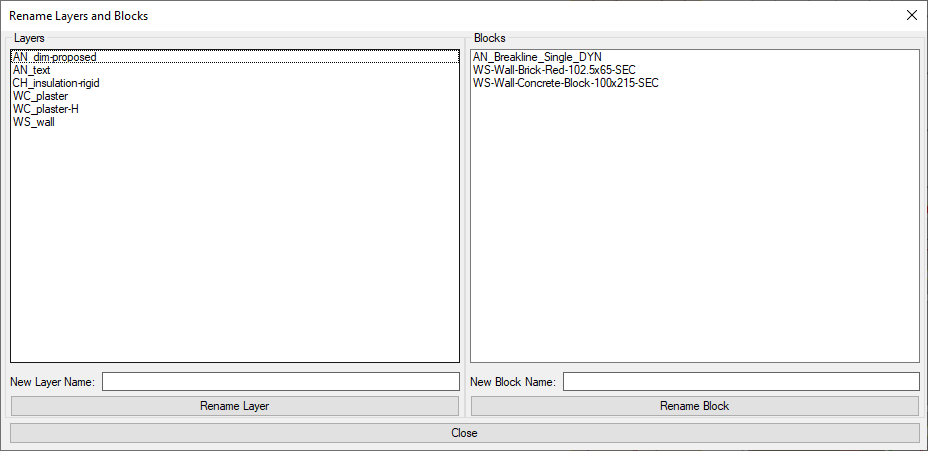

Here's the DCL :
// ;; DCL Code for 3dwannab_Rename_Layers_and_Blocks.dcl
// ;; Save this as 3dwannab_Rename_Layers_and_Blocks.dcl
rename_layer_block : dialog {
  label = "Rename Layers and Blocks";
  : row {
    : column {
      label = "Layers";
      : list_box {
        key = "layer_list";
        width = 75;
        height = 25;
      : edit_box {
        key = "new_layer_name";
        label = "New Layer Name:";
      : button {
        key = "rename_layer";
        label = "Rename Layer";
    : column {
      label = "Blocks";
      : list_box {
        key = "block_list";
        width = 75;
        height = 25;
      : edit_box {
        key = "new_block_name";
        label = "New Block Name:";
      : button {
        key = "rename_block";
        label = "Rename Block";
  : row {
    : button {
      key = "close";
      is_cancel = true;
      label = "Close";
Here's the UI:

I fixed it with the following: I've been at this for 4 hours, yet once I posted here, I found the solution in 10 minutes which is always the way!!
I'll post the full code once I'm happy with it.
EDIT:
Posted the program over here.
  ;; Function to rename a block withing a DCL
  ;; Call the function within the DCL:
  ;; (_renameBlock Oldname NewName)
  (defun _renameBlock (old new / actDoc)
    (if (tblobjname "BLOCK" new)
      (princ (strcat "\n\"" new "\" block aleady exists."))
    (if (and (tblobjname "BLOCK" old) (not (tblobjname "BLOCK" new)))
        (setq actDoc (vla-get-ActiveDocument (vlax-get-acad-object)))
        (vla-SendCommand actDoc (strcat "-rename _B " old "\r" new "\r"))
