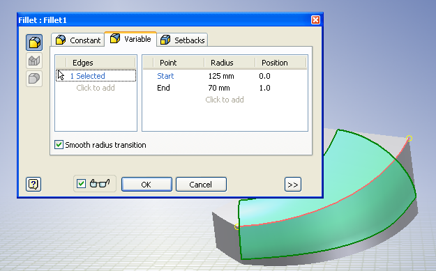

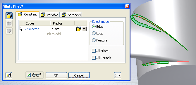

Then add a Varialbe Radius Fillet along the edge shown. Your Start and End radius might be reversed depending on where you pick the arc - doesn't matter as long as you have the visually have the 125 and 70 on correct ends.
I forgot to arrow the important entries in the attached image so study it carefully to see that I am on the Variable tab of the Fillet dialog box.
You might be wondering by now where I am coming up with some of my dimensions. I'll explain that in a bit - and if you want to change any dimensions that is easy enough to do as it is a fully parametric model.

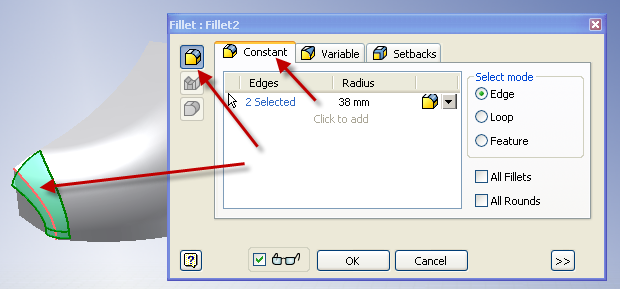

Now as the R38 Fillet to the outer edge as shown.

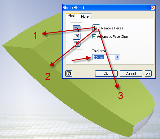

Select the Shell feature and then click the 3 faces shown. Set the Thickness to 16mm and click OK. Let me know when you have completed these steps. One more tricky step and the rest is gravy.
I realized that I might have confused by having the three arrows going from the selection tool it will be active when you start the command - you do not need to click that icon - just click the 3 faces as shown.

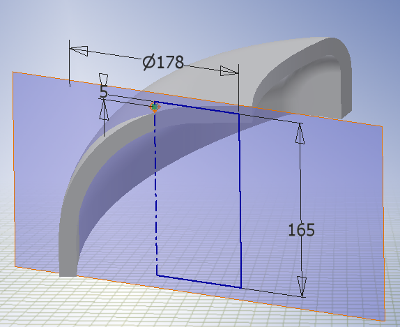

Create the sketch as shown on one of the origin workplanes (I'll let you figure out which one to make it look like attached.) I assume by this point that you are starting to anticipate my method. On your drawing it shows the 5 dimension as 3, but do it as 5 for now. Notice the position of the Origin Center Point. Everything I do is in relation to the origin.
Once you get this sketch Revolve the feature.

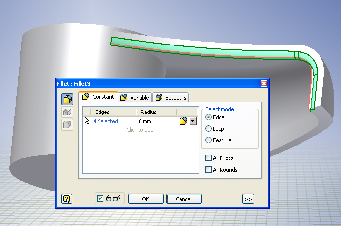

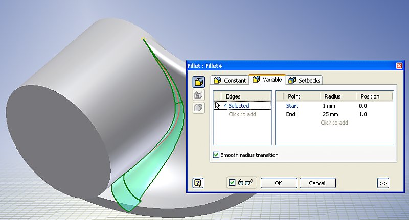

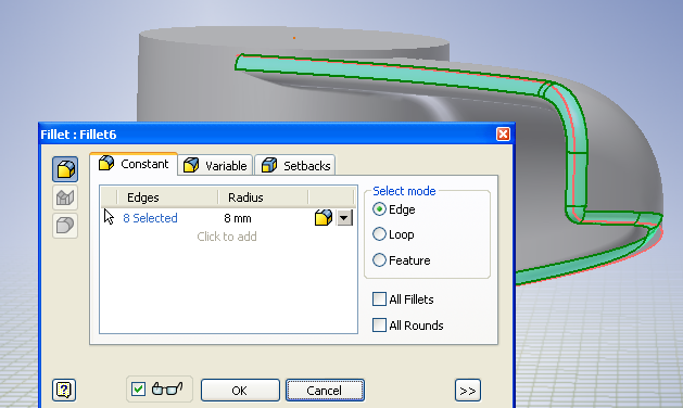

The order in which you place fillets is critically important.
Add the Variable radius fillet to the inside edge as shown.

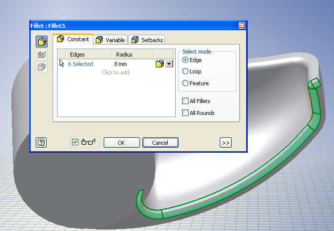

...add fillet to bottom inside edge as shown.
...add the fillet to the upper outside edge.

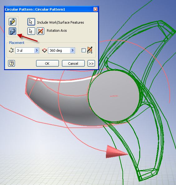

Select Circular Pattern and be sure to click Pattern Entire Solid as shown with the red arrow in attached image, then select appropriate origin axis in the browser.

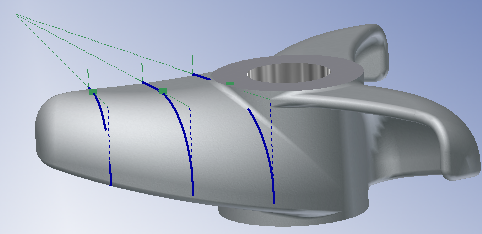

I started out with parallel sections exactly like the original drawing.
As I started constraining it became obvious to me that the original designer fudged some dimensions as they didn't have the advantage of a parametric geometry solver when working on a drawing board.
I decided that even on the drawing board radial sections would have made more sense than parallel sections. I could argue the parallel sections aren't even drawn correctly - the round ends would be ovals in a true projection. See my image of the same sections imposed over my final solution.
To get the final solution I adjusted the variable fillet dimensions to fit the given section dimensions as closely as I could. If these dimensions don't suit you simply keep adjusting till you get what you want.
Thanks very much for all your help. I came to the same conclusion on the dimensions when I first started to draw it. The impeller blade can't be drawn using all the dimensions shown which actually means the sections don't quite line up either. I think the client will be happy with this model and I have sent a copy to him to evaluate and explained about the dimensions on the original drawing. I have managed to figure out the hole myself, and also the circular pattern.
