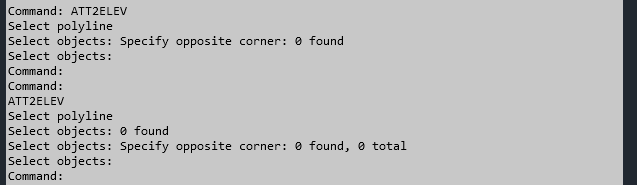

I've attached a video capture of Selev. I've created the Code and APPLOADed it.
the att2elev I have done a video but its too large but essentially, created the code, APPLOADed it. It asks to select objects, which I do then nothing happens. Screenshot below.
Thanks guys.
@Civils_Ben
If att2elev doesn't work, I think it's due to the name of the layer where the polylines are located.
I fixed the name of the layer based on the drawing example you provided.
Here is another version which will be more flexible (it will allow you to choose the layer(s), as well as the block attribute to take into consideration.

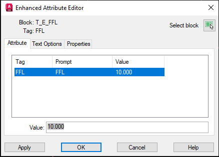

@Civils_Ben
Why not just use a FIELD?
1) Edit the Attribute using the Attribute editor. Right-click and select "Insert Field"
2) In the Field Dialog, Select "Objects" from the popdown list, then "Object" from the list below it:
3) In the middle of the top of the dialog, next to "Object type", use the button, then select the Polyline.
4) When the dialog returns, Select the "Elevation" Property, then set the units and precision on the right.
5) Select "OK" and then see the value displayed in the Attribute Editor.
6) Select OK, the the attribute will display the value. If you change the elevation, then use the UPDATEFIELD command on the block and the attribute will update.
@pkenewell  the attribute holds an elevation, the pline is at say 0.0, so need to set the pline elevation 1st, as you have suggested once the pline has an elevation you could using your method set the attribute to the pline elevation field, that way change the pline value and atrribute updates, matches current sample dwg. You could check the attribute string to see if a field if not then update pline & attribute.
We need @Civils_Ben to confirm the choice of method,  how is the elevation first worked out and do you set pline or attribute ? Is it auto labelled, Civil software can do that sort of thing.
