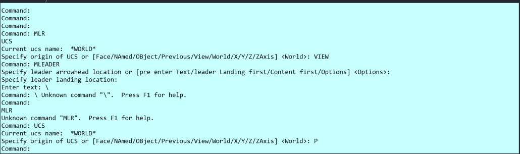

If I understand you correctly, I need to add a Command Pause for each different click. Our leaders are set to have a max number of 2 points, so there should be 3 total pauses, one for each click and then one for text entry. I tried that, and this is what happened in the command line:image.thumb.png.f33587efc2878e510efe9282504ab387.png
For some reason, under text it's just putting a "\" and I never even get the option to enter the text editor. Everything else works, I just have to hit enter after placing the leader to reset the UCS. But I can't for the life of me figure out where the "\" in the multileader text is coming from. Here's the code after I added pauses:

That works perfectly, except that it still doesn't enter the text editor it just places a /. I've tried to change the invoke leader line to "MLEADER" "T" to force it to place the text first but it just freezes my CAD when I do that. I wonder if my company has a system variable set that is screwing with how the multi-leaders work.
@adrath
Unfortunately, the MLEADER text editor doesn't work within the (command) function. The only way I know to do it is to emulate the MLEADER prompts and then run the command after. Try this code:
