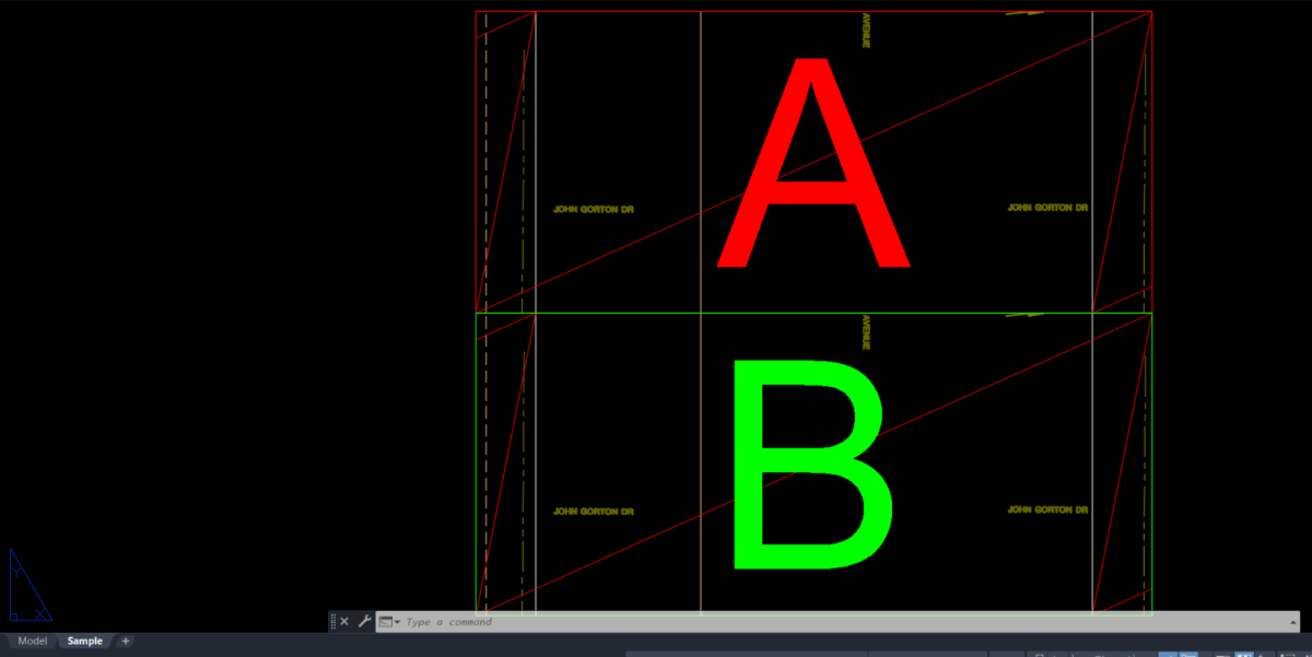

I have multiple drawings with 1 layout and 2 viewports.
I'm trying to find a ways to select the viewport and set to active viewports without double clicking.

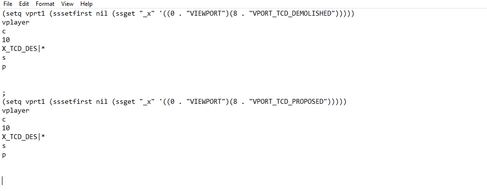

I'm using this to select the viewport.
(sssetfirst nil (ssget "_x" '((0 . "VIEWPORT")(8 . "VPORT_TCD_PROPOSED"))))
But I can not find a command that could set my selected viewport to active.
If I can resolve this I can now use VPLAYER command to an specific viewport.
Any suggestion or solution will be much appriciated.
Thank you.
I found a work around to apply the vplayer for specific viewport.
If anyone have better way of doing this I will really appriciate your input.
In a layout you can get the viewports, (ssget "X" '((0 . "VIEWPORT")(cons 410 (getvar 'ctab)))) the 410 restricts to the current layout tab. if you have 2 Mviews the ssget will return 3 viewports as Pspace is the first viewport. So you can set a viewport as current, now where is it, then using lisp do the vplayer.
