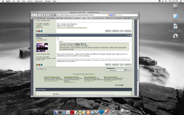

f700es Posted December 14, 2007 Share Posted December 14, 2007 Here is my mac's screen right now. Still playing with new software. Quote Link to comment Share on other sites More sharing options...
