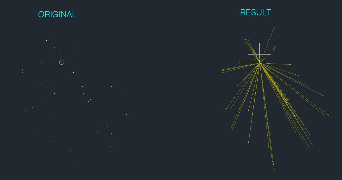

Need a routine lisp
oliver
Try this
(defun c:foo ( / ss e_base pt_base n lst)
  (princ "\nSelect base point:")
  (while (null (setq ss (ssget "_+.:E:S" '((0 . "POINT"))))))
  (setq
    e_base (ssname ss 0)
    pt_base (cdr (assoc 10 (entget e_base)))
  (princ "\nSelect points to connect:")
  (setq ss (ssget '((0 . "POINT"))))
  (cond
    (ss
      (if (ssmemb e_base ss) (ssdel e_base ss))
      (repeat (setq n (sslength ss))
        (setq lst (cons (cdr (assoc 10 (entget (ssname ss (setq n (1- n)))))) lst))
      (mapcar
        '(lambda (x)
          (entmake
            (list
              (cons 0 "LINE")
              (cons 10 pt_base)
              (cons 11 x)
        lst
  (prin1)
  • Like 3
Never fully learned mapcar and at this point probably wont.
(defun c:foo ( / ss base pt)
  (setq base (getpoint "\nSelect Base Point:"))
  (princ "\nSelect Point(s) to Connect:")
  (foreach ent (vl-remove-if 'listp (mapcar 'cadr (ssnamex SS)))
     (setq pt (cdr (assoc 10 ent)))
     (entmake (list '(0 . "LINE") (cons 10 base) (cons 11 x)))
Quote
@mhupp
(mapcar allows you to apply a function to each member of one or more lists and return the resulting list.
simple exemple:
(mapcar '1+ '(0 1 2 3 4)) -> (1 2 3 4 5)
complex (but powerful) example:
(mapcar '(lambda (x y z) (strcat x " "y " " z)) '("me" "you") '("and" "not") '("you" "they")) -> ("me and you" "you not they")
15 hours ago, Tsuky said:
Try this
  (setq
  (cond
    (ss
      (mapcar
        '(lambda (x)
          (entmake
            (list
              (cons 0 "LINE")
              (cons 10 pt_base)
              (cons 11 x)
        lst
  (prin1)
thank you very much...its..working.
