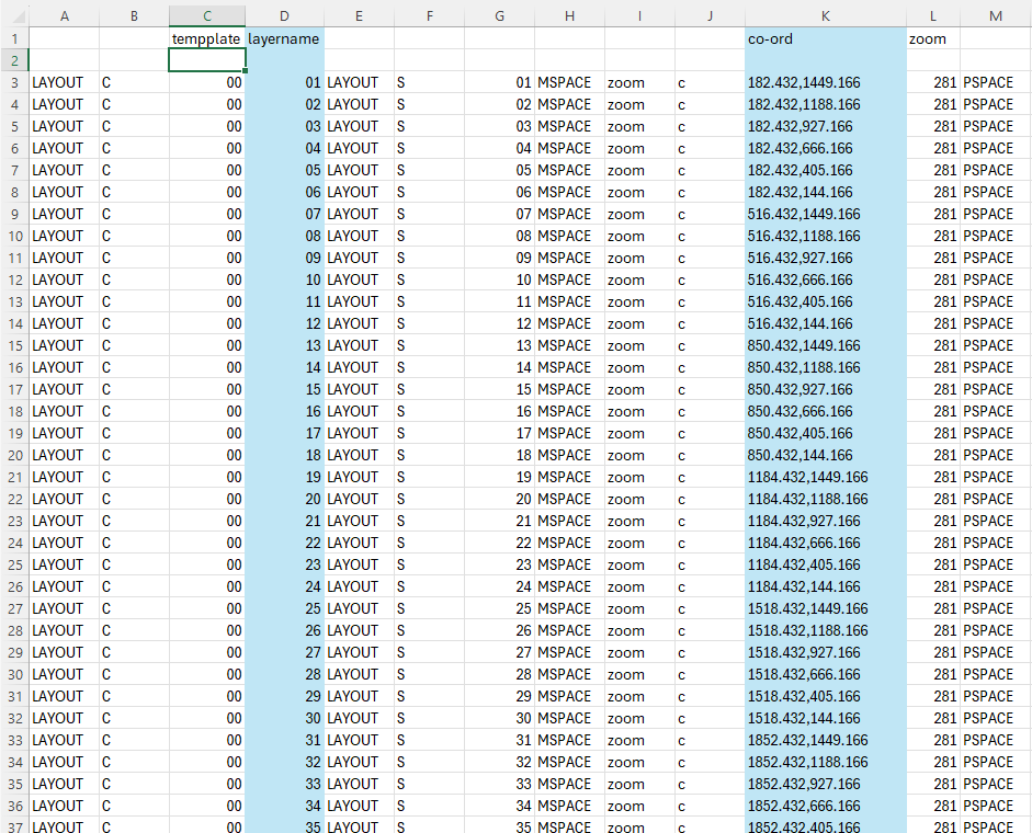

I usually use a mixture of DATAEXTRACT, Excel and Scripts to do this task, and it does the job just fine and relatively quickly (especially compared to doing it manually when there are many many layouts!)

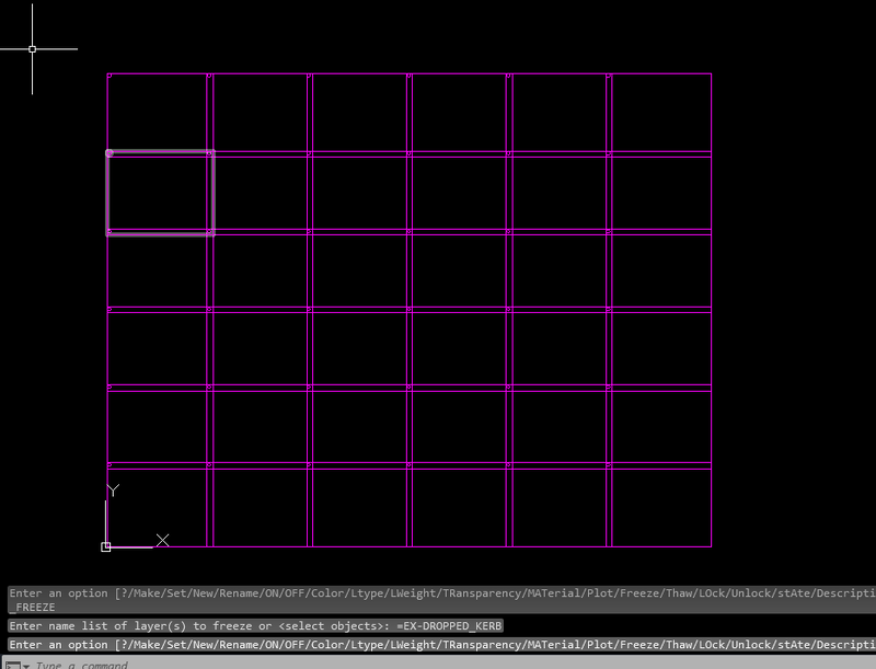

For example, there's a drawing with 36 layouts, and the viewport block on each as below:
The basepoint of every block is bang in the centre. So when I do a DATAEXTRACT for the points, it's the middle and that enables me to write a script to put in all the text, and also automatically build all of the viewports with them in the right location and zoom amount.
See below for the Excel/script examples
Text:
Layouts
So this copies the template layout, selects the new layout, goes into the viewport and zooms into the centre of each block in turn.
As said, this works perfectly well but is obviously a bit clunky and can be annoying if you have to re-do everything when things have moved in the drawing.

A couple of suggestions as your using a block to define the area of interest yes do a what scale required 1st, then insert the block using a scale. You read the scale so know what scale the mview needs to be, you can use "zoom c Point scale" to set the correct scale of the newly made Viewport.
When using copy layout I use Template option so read from another dwg the correct layout size which has a viewport already made see image above.
The ssget add (cons 410 "Model") if block is always in Model space. Saves finding the odd one in a layout.
"set by x/y position" you can do a double sort on a list of block insertion points. Then number.
