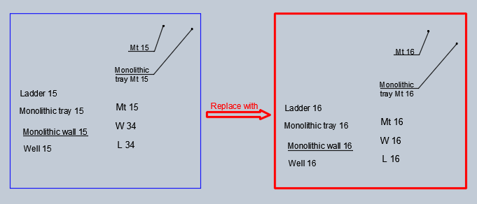

Nikon Posted October 16, 2024 Posted October 16, 2024 (edited) Good day to all! How to replace only the numbers at the end in the text (mtext). Select multiple texts and replace the numbers with the same number. Is there a lisp that allows you to replace only numbers in selected texts? For example: Text 1 Text text 1 Text text text 1 MLeader 1 Replace with: Text 34 Text text 34 Text text text 34 MLeader 34 Is it possible to add MLeaders to the selection? Thank you in advance... Replace numbers.dwg Edited October 16, 2024 by Nikon Quote

Nikon Posted October 16, 2024 Author Posted October 16, 2024 (edited) 25 minutes ago, Emmanuel Delay said: "Text 1text 1" "T3322223333665589657ext text" "Tex44t text text9000" What do you expect there? I have text (or MLeader) with the same numbers at the end (1 or 12 or 33...) I need to replace all the same numbers with other same ones... see the attached .dwg The numbers are only at the end Edited October 16, 2024 by Nikon Quote
Tsuky Posted October 17, 2024 Posted October 17, 2024 With your exemple seem to do the job. (defun extractNumbers (str / l rslt) (setq l (mapcar '(lambda (x) (if (and (> x 44) (< x 58) (/= x 47)) x 32) ) (vl-string->list str) ) l (mapcar '(lambda (x y) (if (not (= x y 32)) x) ) l (append (cdr l) '(32)) ) l (vl-remove-if-not '(lambda (x) (eq (type x) 'INT) x) l) l (mapcar '(lambda (x) (if (not (eq x 32)) x (list nil))) l) ) (eval (read (strcat "(setq rslt (list " (apply 'strcat (mapcar '(lambda (x) (if (not (listp x)) (chr x) " ")) l)) "))"))) ) (defun c:replacenumber ( / ss nb n ename dxf_ent txt old_num old_list) (setq ss (ssget '((0 . "*TEXT")))) (cond (ss (initget 1) (setq nb (getint "\nEnter number to substitue: ") nb (vl-string->list (itoa nb)) ) (repeat (setq n (sslength ss)) (setq ename (ssname ss (setq n (1- n))) dxf_ent (entget ename) txt (cdr (assoc 1 dxf_ent)) ) (setq old_num (vl-string->list (itoa (car (extractNumbers txt)))) old_list (vl-string->list txt) ) (foreach e old_num (setq old_list (vl-remove e old_list))) (entmod (subst (cons 1 (vl-list->string (append old_list nb))) (assoc 1 dxf_ent) dxf_ent)) ) ) ) (prin1) ) 1 Quote
Nikon Posted October 17, 2024 Author Posted October 17, 2024 5 hours ago, Tsuky said: (defun c:replacenumber @Tsuky Thanks a lot! This code handles text and mtext well. Is it possible to add MLeader and attributes? I have similar designs that I copy, modify and change the names with numbers. I changed 30-40 titles one by one, I caught myself at number 35 and asked for help, I will need to change 100 or more numbers. You have helped me a lot! Quote
Tsuky Posted October 17, 2024 Posted October 17, 2024 Quote Is it possible to add MLeader and attributes? Tested briefly .... (vl-load-com) (defun extractNumbers (str / l rslt) (setq l (mapcar '(lambda (x) (if (and (> x 44) (< x 58) (/= x 47)) x 32) ) (vl-string->list str) ) l (mapcar '(lambda (x y) (if (not (= x y 32)) x) ) l (append (cdr l) '(32)) ) l (vl-remove-if-not '(lambda (x) (eq (type x) 'INT) x) l) l (mapcar '(lambda (x) (if (not (eq x 32)) x (list nil))) l) ) (eval (read (strcat "(setq rslt (list " (apply 'strcat (mapcar '(lambda (x) (if (not (listp x)) (chr x) " ")) l)) "))"))) ) (defun c:replacenumber ( / ss nb n ename txt rslt old_num old_list) (setq ss (ssget (list (cons 0 "*TEXT,MULTILEADER,INSERT") (cons 67 (if (eq (getvar "CVPORT") 2) 0 1)) (cons 410 (if (eq (getvar "CVPORT") 2) "Model" (getvar "CTAB"))) ) ) ) (cond (ss (initget 1) (setq nb (getint "\nEnter number to substitue: ") nb (vl-string->list (itoa nb)) ) (repeat (setq n (sslength ss)) (setq ename (vlax-ename->vla-object (cadar (ssnamex ss (setq n (1- n))))) ) (cond ((vlax-property-available-p ename 'TextString) (setq txt (vlax-get ename 'TextString)) (cond ((eq (type (setq rslt (car (extractNumbers txt)))) 'INT) (setq old_num (vl-string->list (itoa rslt)) old_list (vl-string->list txt) ) (foreach e old_num (setq old_list (vl-remove e old_list))) (vlax-put ename 'TextString (vl-list->string (append old_list nb))) ) ) ) (T (mapcar '(lambda (att) (setq txt (vlax-get-property att 'TextString)) (cond ((eq (type (setq rslt (car (extractNumbers txt)))) 'INT) (setq old_num (vl-string->list (itoa rslt)) old_list (vl-string->list txt) ) (foreach e old_num (setq old_list (vl-remove e old_list))) (vlax-put-property att 'TextString (vl-list->string (append old_list nb))) ) ) ) (vlax-invoke ename 'GetAttributes) ) ) ) ) ) ) (prin1) ) 1 Quote

Nikon Posted October 17, 2024 Author Posted October 17, 2024 50 minutes ago, Tsuky said: This version ? replacenumber.lsp @Tsuky very, very grateful! This code performs the task wonderfully! Now the work will go faster... Quote

Nikon Posted October 18, 2024 Author Posted October 18, 2024 58 minutes ago, Emmanuel Delay said: @Nikon is your problem solved? Thanks, the problem is solved. The code Tsuky (replacenumber.lsp) works perfectly. Quote
