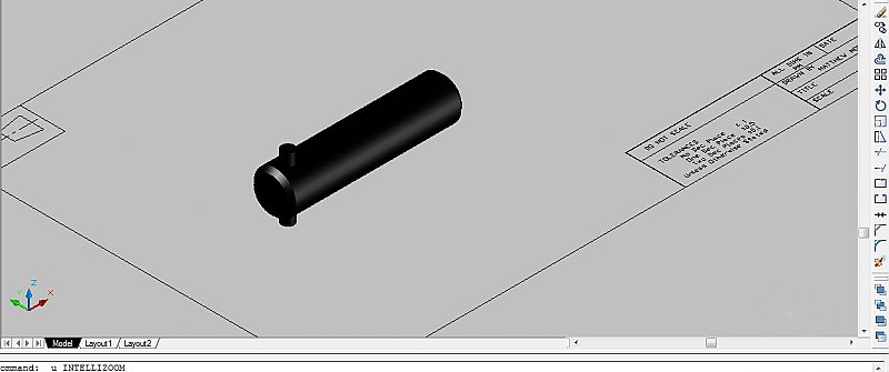

Is there anyway to shade the component only? When I gouraud shade using the option it shades the component correctly but the background grey.
Thanks,
I suppose you could use a viewport to show different shades? Is that possible.. :P
Yes, It's possible but I don't know if its permitted in my work.

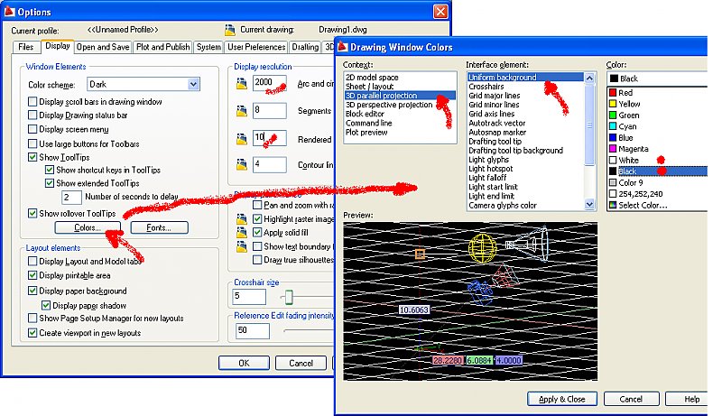

Options
Display tab
Colors

Is it possible to change colours of the shading? For example on this component I cannot see the cylinder correctly so it would be best for the cylinder to be silver and the background to untouched (not silver). Can that only be done through a viewport?
You are seeing the background as color set in Options.
The color was changed in r2007 but the method to change has been the same as far back as I can remember. CAD 101.
Did you try changing it to black or white?
Hi,
I cannot find these selections. Can you post a screenshot or something of where the options are to change the colour is?
Thanks
See attached.
