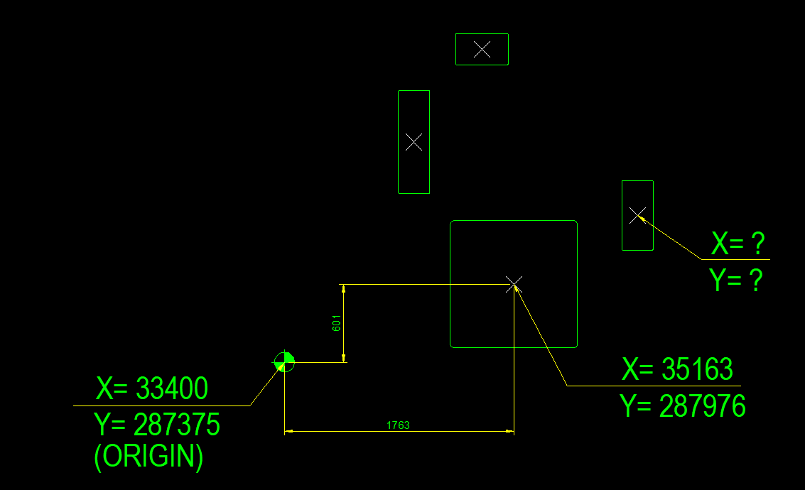

leonucadomi Posted October 10, 2024 Posted October 10, 2024 hello all: I would like your help to know if there is a lisp routine that helps check coordinates when you have a non-zero origin without having to move the drawings to the coordinate. What I'm looking for is to assign an origin different from 0,0 and then list points to obtain the coordinates of the following figures without having to draw dimensions or do addition or subtraction or even without having to move the drawings since they are already arranged in viewports I use the 2013 version. any comments are welcome thnaks ORIGIN.dwg Quote
BIGAL Posted October 10, 2024 Posted October 10, 2024 (edited) Just do UCS OR, set a point as new 0,0 then I would do UCS S "MYUCS" then you can switch between your UCS and World, UCS W. Not sure how your doing the leaders, the X & Y value. Edited October 10, 2024 by BIGAL 1 Quote
