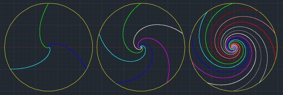

fuccaro Posted Thursday at 09:57 AM Share Posted Thursday at 09:57 AM I saw an interesting math problem. A group of mice find a round cheese and start eating it. At first, they spread evenly around the perimeter of the cheese and start eating at the same time, at the same speed. The first mouse will advance in the direction of the second, the second mouse will advance in the direction of the third, ...the last mouse will advance in the direction of the first. Draw the cheese after the mice meet. Here are my cheeses eaten by 3, 5 and 10 mice. And here is the Lisp I wrote. (defun c:cheese() (setq mice 10 micePoz nil ang1 (/ PI 0.5 mice) ang 0 R 100.0 seg 0.1 continue T) (entmake (list (cons 0 "CIRCLE") (list 10 0.0 0.0) (cons 40 R) (cons 62 2))) (repeat mice (setq micePoz (cons (list (* R (sin (setq ang (+ ang ang1)))) (* R (cos ang))) micePoz)) ) (While continue (setq i -1 nextPoz nil) (repeat mice (setq i (1+ i) j (rem (1+ i) mice)) (setq m1 (nth i micePoz) m2 (nth J micePoz) dist (distance m1 m2) p (/ seg dist)) (setq nextPoz (cons (list (+ (car m1) (* p (- (car m2) (car m1)))) (+ (cadr m1) (* p (- (cadr m2) (cadr m1))))) nextPoz)) ) (setq nextPoz (reverse nextPoz) i -1) (repeat mice (entmake (list (cons 0 "LINE") (cons 10 (nth (setq i (1+ i)) micePoz)) (cons 11 (nth i nextPoz)) (cons 62 (+ 3 (* i 1))))) ) (setq micePoz nextPoz nextPoz nil) (setq continue (> dist (* 1 seg))) ) ) Finally, here's a mouse looking for the next cheese. (defun c:mouse() (setq db (list -5.5 -0.15 1.0 3.8 5.9 -5.3 -2.0 1.6 1.1 2.3 -20.8 -18.4 19.3 1.0 1.3 -19.2 -8.9 11.4 0.7 1.1 -30.2 -16.6 25.2 0.7 0.8 -5.1 -17.9 14.2 1.4 1.7 11.8 -68.0 69.2 1.8 1.88 39.3 -121.0 127.0 1.9 1.9 -2.4 1.6 2.5 5.9 0.6 0.6 3.6 1.2 2.5 3.7 2.7 2.2 3.8 2.1 2.5 12.0 -225.6 226.7 1.6 1.6 13.4 -3.4 4.6 1.1 1.6 15.6 1.3 0.6 4.3 5.1 15.4 1.6 0.9 5.1 0.9 17.1 3.8 1.8 3.1 4.1 16.1 3.9 0.9 2.0 3.1 15.8 4.6 0.1 5.7 2.0 17.0 3.8 1.4 2.6 4.3 16.1 1.4 1.3 0.0 1.2 15.7 1.3 1.6 4.7 0.0 16.0 6.7 7.0 4.5 4.7 13.17 -5.1 5.1 1.3 2.1 13.7 -7.4 6.0 2.6 2.7 10.4 -5.8 2.2 2.7 3.2 8. -5.9 0.3 3.2 4.9 8.4 -5.4 0.8 4.9 5.9 14.6 -6.1 5.5 3.0 3.1 9.7 -5.7 0.6 3.1 4.5 9.7 -5.8 0.55 4.5 0.2 11.3 -4.9 1.4 3.3 4.2 10.8 -5.8 0.4 4.2 0.34 8.4 -6.7 2.9 0.4 0.9 11.8 -2.2 2.7 3.7 4.1 -1.9 -1.2 4.0 5.0 5.9 -4.1 6.3 11.7 4.5 5.0 -0.5 4.9 7.0 2.9 3.4 -5.9 6.1 1.4 0.5 2.9 -7.8 5.0 3.7 6.2 0.5 -8.4 -3.4 2.8 3.5 0.2 -9.1 -3.6 2.1 2.7 3.5 62.2 -41.66 82.9 2.6 2.7 -3.5 -0.6 5.4 1.7 2.6 -1.8 -10.3 15.8 1.5 1.7 -5.2 -5.9 1.9 5.4 6.1 -2.7 -8.6 1.8 2.3 2.9 -4.2 -8.3 0.3 2.9 5.0 -4.2 -8.2 0.4 5.0 6.0 -2.6 -8.3 1.3 2.7 3.6 -3.3 -8.7 0.4 3.6 0.1 -1.3 -8.1 1.7 2.8 3.6 -2.7 -8.8 0.2 3.6 5.8 -3.5 -8.3 1.2 5.8 6.3 2.5 -8.0 4.9 3.1 3.2 -2.0 -8.3 0.4 3.2 5.3 -2.0 -8.3 0.5 5.3 0.7 0.6 -5.8 3.2 3.7 3.9 -1.2 -6.9 1.0 2.9 3.7 0.5 4.5 11.4 4.2 4.8 1.7 -7.1 0.2 0.2 1.7 1.1 -7.2 0.9 5.0 0.2 0.2 -2.7 5.5 4.7 4.9 0.4 -9.4 1.3 1.6 2.8 -0.6 -9.1 0.27 2.8 4.8 -0.6 -8.7 0.7 4.8 5.4 1.2 -9.8 1.5 2.1 2.7 0.3 -9.4 0.4 2.7 5.3 -1.1 -7.4 2.9 5.3 5.6 2.4 -9.45 1.2 2.2 3.3 1.5 -9.67 0.4 3.2 6.2 2.9 -9.6 1.0 2.2 3.2 2.5 -9.0 0.3 6.0 2.2 2.9 -9.1 0.2 2.9 0.3 5.4 -8.5 2.4 1.9 3.4 2.9 -2.0 4.6 5.1 0.56 0.8 3.1 3.0 4.6 5.9 -2.3 4.5 6.4 5.8 0.1 2.4 4.7 1.7 0.1 1.9 6.3 -6.7 13.8 1.9 2.1 0.0 3.1 2.2 2.1 2.7 -11.7 -3.86 1.5 5.5 1.0 4.6 0.3 6.1 4.8 1.8) ) (setq i 0) (repeat 82 (entmake (list (cons 0 "ARC") (list 10 (nth i db) (nth (1+ i) db)) (cons 40 (nth (+ 2 i) db)) (cons 50 (nth (+ 3 i) db)) (cons 51 (nth (+ 4 i) db)))) (setq i (+ 5 i)) ) ) Do you have other solutions for this cheese problem? 2 Quote Link to comment Share on other sites More sharing options...

fuccaro Posted Thursday at 10:50 AM Author Share Posted Thursday at 10:50 AM All the numbers in the database are with only one decimal - just to reduce the file size. That's the reason the mouse is so... "exploded" Quote Link to comment Share on other sites More sharing options...

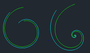

lrm Posted Thursday at 02:49 PM Share Posted Thursday at 02:49 PM (edited) @marko_ribarI'm not sure that an AutoCAD helix would provide the correct shape. The spacing between succesive turns of an AutoCAD helix is constant where as the Cheese and Mouse curves converge. The curves on the left in the image below are helixes with one rotated by 36°. The curves on the right are "Cheese and Mouse" curves. [EDIT here's the image that wasn't included] Edited Thursday at 06:10 PM by lrm Quote Link to comment Share on other sites More sharing options...
marko_ribar Posted Thursday at 03:44 PM Share Posted Thursday at 03:44 PM @lrm I guess you are right... BTW. I've found link on Wikipedia about logarithmic spirals... I think that this is what OP searched for, but he succedded to convert all those formulas into lisp... So, here is the link : https://en.wikipedia.org/wiki/Logarithmic_spiral Quote Link to comment Share on other sites More sharing options...
fuccaro Posted Thursday at 05:44 PM Author Share Posted Thursday at 05:44 PM I'm not sure that's a logarithmic spiral, but I may be wrong. Could you prove it? Quote Link to comment Share on other sites More sharing options...

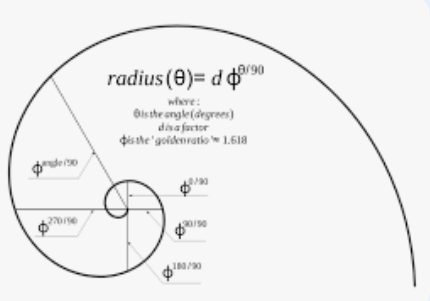

lrm Posted Thursday at 06:47 PM Share Posted Thursday at 06:47 PM I'm putting my money on a Fibonacci spiral. https://gist.github.com/feromes/2c5243a6183c7c6000987ee7b22db086 Quote Link to comment Share on other sites More sharing options...

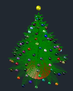

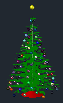

BIGAL Posted Thursday at 11:42 PM Share Posted Thursday at 11:42 PM (edited) Another coming soon ChristmasTree4.lsp Edited Monday at 09:45 PM by BIGAL 2 1 Quote Link to comment Share on other sites More sharing options...
Nikon Posted Friday at 07:03 AM Share Posted Friday at 07:03 AM (edited) 7 hours ago, BIGAL said: Another coming soon ChristmasTree4.lsp !!! That's cool !!! Edited Friday at 07:08 AM by Nikon Quote Link to comment Share on other sites More sharing options...

Nikon Posted Friday at 04:31 PM Share Posted Friday at 04:31 PM 16 hours ago, BIGAL said: ChristmasTree4.lsp I wonder how it looks together with the image? (command "_-image" "_attach" "santa sleigh.png" "50,50,50" 5.0 90.) Quote Link to comment Share on other sites More sharing options...
Steven P Posted Friday at 04:33 PM Share Posted Friday at 04:33 PM Its a sleigh flying around it (I don't have that either but.. suspect it looks pretty good) 1 Quote Link to comment Share on other sites More sharing options...
