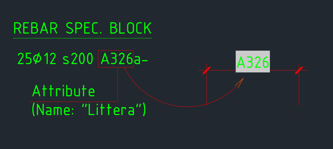

Hi all,
Again I have found a lisp Lee Mac made that copies a field into a dimension, "copyfield", but it requires that the field already exists...
So is there a way to create a field from an attribute in a block and then insert the field directly into a dimension?
Thanks in advance.

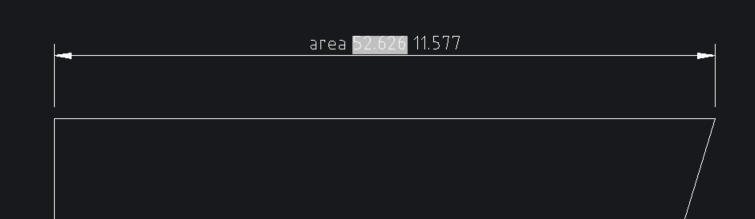

You can do a dimension then update the dimension string with a field just double click the dimension and a field is an option. In image move corner point and dim updates both normal length and area.

I have rebar block with a rebar number called "Littera". I would be great if I could place that directly into the dimesnsion, which works as a marker for in what area the rebars are to be placed.

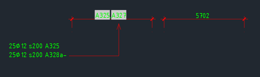

The other attributes and "Littera" are for extraction to excel to sort them there.

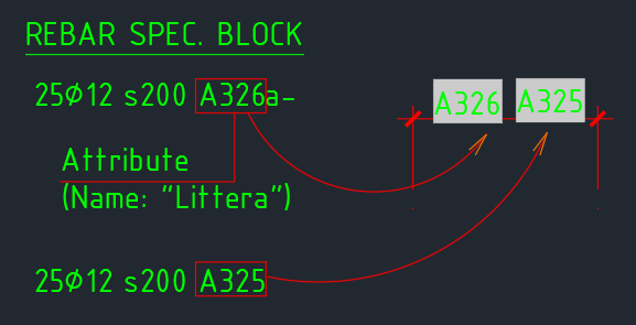

What i was hoping for, was if one, two or more different "Littra" can be put into same dimension as field?
But multiple attributes as text answer into dimension from different blocks would be nice as well.
Yes should be the answer, I have take 2 attributes add them together and put result into a 3rd attribute all as fields. Should be able to do pick pick etc 1 - ? then put in a dim.
Try this pick the attributes. Tested on 1 2 & 3 attributes.

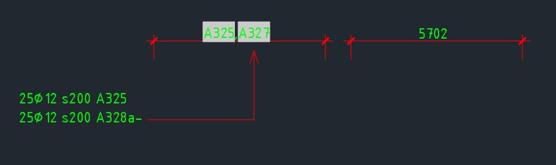

Thank you very much Bigal! Works super! I could even put the chosen attribute into a block as a field.
By the way, and I hope I'm not pushing it. Is there a way to put in commas between the attributes? Thanks again!
Try this version

But it seems like something happend. When I update an attribute it won't change in the dimension. And when I go into the dimension the fields isn't there and it turns back to a plain dimension. What am I missing?
You are right I changed the attribute value and the dim field did not update. I did the same to a mtext and it worked. It looks like you can not Update the dim value. May have to look at a dynamic block with a attribute.
Any body have an idea ?
Maybe ask over at forums/autodesk post link to here.
Ok probably only way is make a dim block with also a Mtext value. Have the measurement set to blank eg space. insert it, align the dim and stretch etc, explode,  then code will work.

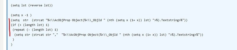

;; Get ObjectId and create fielexpression
            (setq objid (vla-get-ObjectId (vlax-ename->vla-object ent)))
            (setq fldexp (strcat "%<\\AcObjProp Object(%<\\_ObjId " (itoa objid) ">%).TextString>%"))
I found the part of a code above. And I'm wondering if it somehow could be used in this section of the code?
The problem is not in the code but rather that a dimension does not update when the attribute is changed. Only way around it is to use a Mtext.
