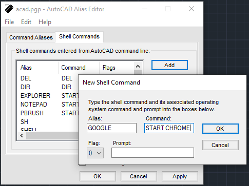

Saxlle Posted October 9 Share Posted October 9 (edited) Hi @Travaci You can do it like this: (defun wsite (/ thisdrawing) (setq thisdrawing (vla-get-activedocument (vlax-get-acad-object))) (vla-SendCommand thisdrawing (strcat "_browser" " " "https://www.cadtutor.net/forum/forum/15-autolisp-visual-lisp-amp-dcl/" " ")) --> this is example for link after "https://...." (princ) ) Another way (picture 1): - Type in AutoCAD: ALIASEDIT - Go to "Shell Commands" - Click Add Button - Enter the Alias (if you use for e.g. CHROME): GOOGLE - Command: START CHROME - Click OK, Apply, ... - After everything are saved, type GOOGLE to run CHROME. Best regards. Edited October 9 by Saxlle Quote Link to comment Share on other sites More sharing options...

Saxlle Posted October 9 Share Posted October 9 1 hour ago, Travaci said: i want to search in google As i described to you on the picture 1, if you are using other Browser for search (Chrome, Edge, Firefox, Opera,....) change this two steps: 1. Enter the Alias (if you use for e.g. Firefox, Opera, Edge,....): "Put any name which you want" (it will be like command, for e.g. you use PLINE for polyline) 2. Command: START "Put the name of BROWSER" (Opera, Firefox,....). - Click OK, Apply, ... - After everything are saved, type "Name which you put for Alias" to start desired Browser inside AutoCAD. Quote Link to comment Share on other sites More sharing options...
