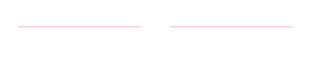

Just trying that, it isn't working.... but you've told me that all ready. Looks like the hatches are hatching 3d lines - If I redraw the boundaries, hatch and then NONZ the new hatch does as expected.
Just thinking as a fix, select all hatches - selection set - redraw the hatch, delete the original with the hatch points all at z=0, or recreate the boundaries and new hatch from there
It would be a huge undertaking on the existing detail library in the office to redraw everything but I guess that's what I'm going to have to do. I wasn't aware that objects can still have their own UCS. I don't understand how they can appear flat in the front view.
FRONT VIEW OF THE ATTACHED (not very exciting to look at)
Hatch example.dwg
Edited by 3dwannab
That's the first thing I looked at too - a few 3d polylines are slightly off 0 z axis (like 0.000026, something like that)
LISP would do the hatches no problem I think, do as a batch process and shouldn't be too painful -  lunchtime walk while the machine does it stuff. Not sure the best way to go with that yet, perhaps entmake the hatch but apply (massoc.... ) lisp to the coordinates and entmod them with the result set with z axis set to 0 (mapcar '* '(1 1 0) coord ).. think that should work?

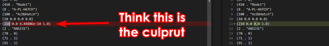

I've noticed that the extrusion direction dxf code 210 is different on both hatches.
shouldn't have that... entmod them all to 0 extrusion?
  • Agree 1
This is a testing version only but it seems to work. I wonder what CAD wizard made this mess of a detail library 🥰

Man, this drawing is a nightmare. 😵‍💫
I have this polyline with a 210 DXF of (210 0.0 0.0 -1.0)
See attached.
I've updated my code to include the DXF codes 220 and 230.
When I run the program on this line it flips it seeing as the Z vector is -1.0.
