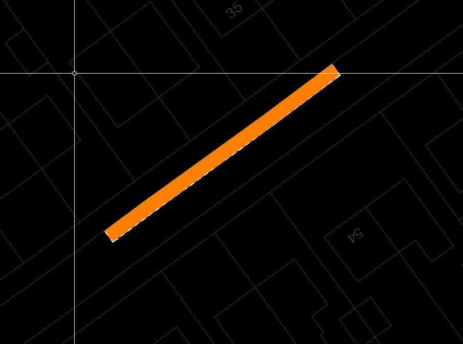

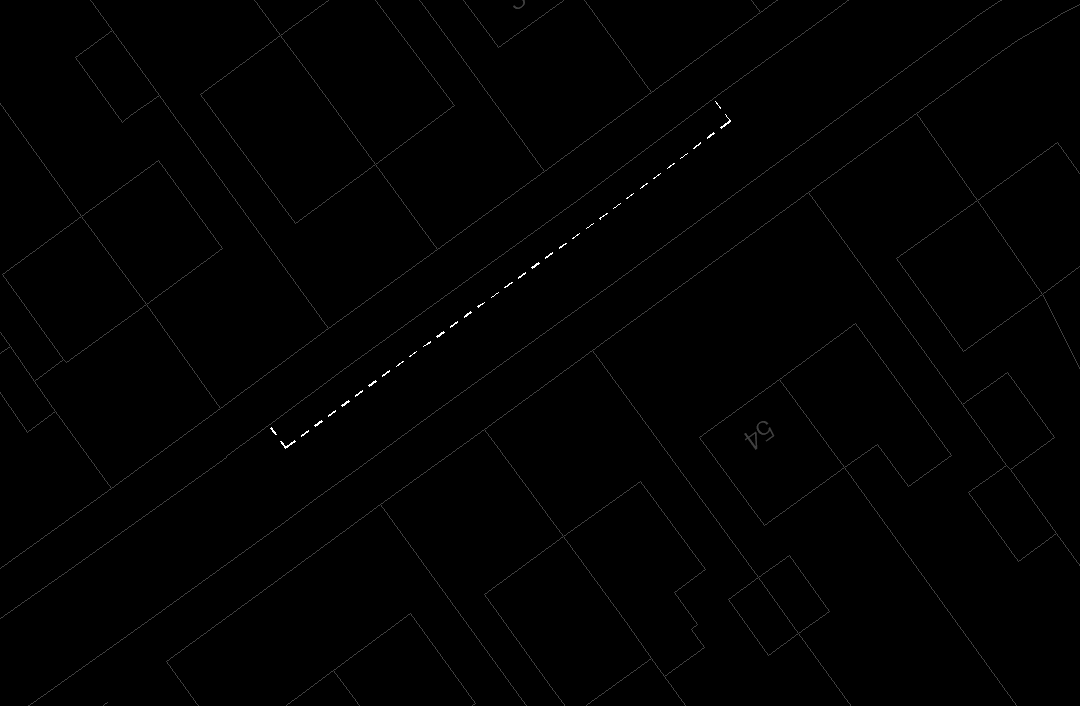

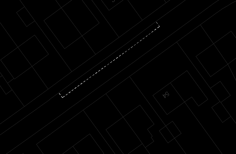

highrise_uk Posted October 4, 2024 Posted October 4, 2024 (edited) Hi all, Been reading the forums for ages, but finally have a thing I'd like some help figuring out. I mostly use CAD to do town planning parking work. Our company has a design style whereby we fill all the proposed parking bays with a certain colour polyline. I made my first working LISP last week, which allows you to select the long line of the bay, then choose which side to make an offset line. Then it makes it the right thickness and also the right layer, and moves it to back, and then repeats so you can do many in quick sucessions: See pics for example: This is cool and enables me to do this for all the bays relatively quickly. But, knowing how good LISPs can be, I was wondering if there was a way of automating it to do this for every single bay in the drawing. Here's the current LISP: (defun C:PBH () (repeat 1000 (command "pselect" pause "") ;select line (command "offset" "e" "n" "1" pause "") ;select offset side (command "pselect" "l" "") ;auto-select previous item (setq ss (ssget "I")) ;set item to ss (command "_.chprop" ss "" "LT" "Bylayer" "LA" "PR-HATCH-PARKING BAY-RESIDENT PERMIT ONLY" "") ;set item to layer (command "_pedit" ss "W" "2" "") ;set item to 2m width (command "pselect" "l" "") ;auto-select last item (command "draworder" "b" "" "") ;send item to back ) (princ) ) I was thinking, if there was a way for the program to find all lines on the parking bay layer longer than 2m (to make it ignore the short ones at each end), and then automatically work out which side those short lines are so that it knows what side to make the fill line, and do this for every item. Is there a get command or something which would assess which direction those short lines were facing, (they are touching the long line), and then run that command on everything. Been really enjoying gradually learning how these work, I'm assuming this would make it a lot more complicated but I'm keen to experiment if it's possible. Cheers Edited October 4, 2024 by highrise_uk Quote

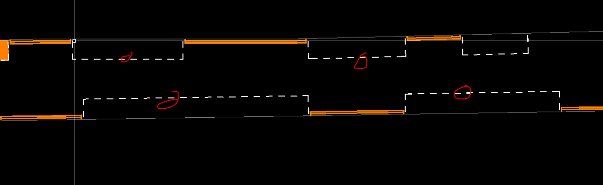

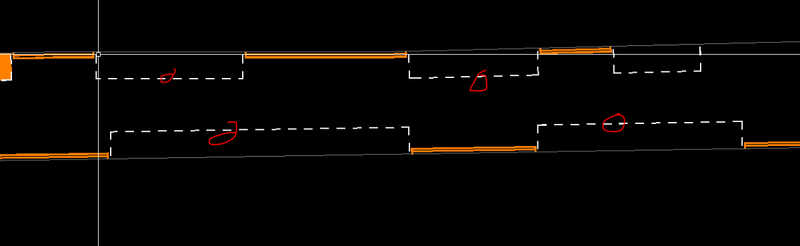

highrise_uk Posted October 15, 2024 Author Posted October 15, 2024 (edited) Hi all, Thanks for the replies! Been busy so not had a chance to reply until now. @Steven P cheers for the reply. Will investigate the while function, I'd read about it before but was in a rush to get this finished and the 1000x repeat seemed a useful but dirty way to go for now haha. The plines are not [ shaped, each bay is made of 3 plines. @mhupp thanks for this. Was helpful reading the code along with the notes. However, it does not allow me to select the lines using this LISP. It says 'cant offset selected object'. I tried this with a new DWG with a few polylines in and got the same result. I have attached my LISP (i guess its more of a macro really, also requires Properties to be opened first to work, as PSELECT seems to not exist until that's happened) and a drawing file showing a snapshot of what I'm dealing with. The bays are initially drawn using KeyLINES and then exploded into polylines. PARKING BAY HATCHER.lsp ParkingBaysTest.dwg What I was thinking for this LISP is if there was a way of selecting all of the long lines of the bays into a selection set (by filtering the whole layer to lines over 2m long)... ... and then maybe some kinda foreach command which would cycle through them, zooming in and allowing a single click to run the offset/layer/width work on the line, with the only user input needed being selecting the offset side which then triggers the view to move to the next line, and repeat. Basically what Steven said above! Quote If it was me I'd perhaps create a selection set of the parking bay lines and loop through that set (as above), zoom to and highlighting each polyline in turn (use redraw -entity name- 3 to highlight, 4 to remove highlight), user can select side, draw the hatch and move on. Unless this can be automated somehow like in my original thought, by making the program work out which way the short lines are pointing... i was thinking since they're touching there must be some code which works out the entity and can work out the direction based on the co-ords of each end against the co-ords of the line we're looking to offset. Cheers Edited October 15, 2024 by highrise_uk Quote
Tsuky Posted October 15, 2024 Posted October 15, 2024 And this way? You simply select the polyline (without the returns), this automatically detects the side to be offset. (defun C:PBH ( / ss acadObj ename start_pt end_pt ang_ori ss_start ent_start pt_start pt_end vla_obj v1 v2 det_or offset_val nw_obj) (princ "\nSelect polyline.") (while (null (setq ss (ssget "_+.:E:S" (list (cons 0 "LWPOLYLINE") (cons 67 (if (eq (getvar "CVPORT") 1) 1 0)) (cons 410 (if (eq (getvar "CVPORT") 1) (getvar "CTAB") "Model")) (cons 8 "KTS_TRO_White") ) ) ) ) ) (setq acadObj (vlax-get-acad-object) ename (ssname ss 0) start_pt (vlax-curve-GetPointAtParam ename (vlax-curve-GetStartParam ename)) end_pt (vlax-curve-GetPointAtParam ename (vlax-curve-GetEndParam ename)) ang_ori (angle start_pt end_pt) ) (vla-ZoomWindow acadObj (vlax-3d-point start_pt) (vlax-3d-point end_pt)) (setq ss_start (ssget "_C" (mapcar '- start_pt '(0.25 0.25 0.0)) (mapcar '+ start_pt '(0.25 0.25 0.0)) (list (cons 0 "LWPOLYLINE") (cons 67 (if (eq (getvar "CVPORT") 1) 1 0)) (cons 410 (if (eq (getvar "CVPORT") 1) (getvar "CTAB") "Model")) (cons 8 "KTS_TRO_White") ) ) ent_start (ssname (ssdel ename ss_start) 0) pt_start (vlax-curve-GetPointAtParam ent_start (vlax-curve-GetStartParam ent_start)) pt_end (vlax-curve-GetPointAtParam ent_start (vlax-curve-GetEndParam ent_start)) vla_obj (vlax-ename->vla-object ename) ) (setq v1 (mapcar '- (polar start_pt ang_ori 1.0) pt_end) v2 (mapcar '- start_pt pt_end) det_or (apply '(lambda (x1 y1 z1 x2 y2 z2) (- (* x1 y2) (* y1 x2))) (append v1 v2) ) ) (cond ((< det_or 0.0) (setq offset_val -1)) ((> det_or 0.0) (setq offset_val 1)) ) (vla-Offset vla_obj offset_val) (setq nw_obj (vlax-ename->vla-object (entlast))) (vla-put-Layer nw_obj "PR-HATCH-PARKING BAY-RESIDENT PERMIT ONLY") (vla-put-Linetype nw_obj "ByLayer") (vla-put-ConstantWidth nw_obj 2) (sssetfirst nil (ssadd (entlast))) (ai_draworder "_back") (vla-ZoomPrevious acadObj) (prin1) ) 1 Quote

Tsuky Posted October 15, 2024 Posted October 15, 2024 Without any selection, we can do like this: (defun C:PBH ( / ss n ename lg acadObj start_pt end_pt ang_ori ss_start ent_start pt_start pt_end vla_obj v1 v2 det_or offset_val nw_obj) (setq ss (ssget "_X" (list (cons 0 "LWPOLYLINE") (cons 67 (if (eq (getvar "CVPORT") 1) 1 0)) (cons 410 (if (eq (getvar "CVPORT") 1) (getvar "CTAB") "Model")) (cons 8 "KTS_TRO_White") ) ) ) (cond (ss (repeat (setq n (sslength ss)) (setq ename (ssname ss (setq n (1- n))) lg (vlax-curve-GetDistAtParam ename (vlax-curve-GetEndParam ename)) ) (if (< lg 1.81) (ssdel ename ss) ) ) ) ) (setq acadObj (vlax-get-acad-object)) (cond (ss (repeat (setq n (sslength ss)) (setq ename (ssname ss (setq n (1- n))) start_pt (vlax-curve-GetPointAtParam ename (vlax-curve-GetStartParam ename)) end_pt (vlax-curve-GetPointAtParam ename (vlax-curve-GetEndParam ename)) ang_ori (angle start_pt end_pt) ) (vla-ZoomWindow acadObj (vlax-3d-point start_pt) (vlax-3d-point end_pt)) (setq ss_start (ssget "_C" (mapcar '- start_pt '(0.25 0.25 0.0)) (mapcar '+ start_pt '(0.25 0.25 0.0)) (list (cons 0 "LWPOLYLINE") (cons 67 (if (eq (getvar "CVPORT") 1) 1 0)) (cons 410 (if (eq (getvar "CVPORT") 1) (getvar "CTAB") "Model")) (cons 8 "KTS_TRO_White") ) ) ent_start (ssname (ssdel ename ss_start) 0) pt_start (vlax-curve-GetPointAtParam ent_start (vlax-curve-GetStartParam ent_start)) pt_end (vlax-curve-GetPointAtParam ent_start (vlax-curve-GetEndParam ent_start)) vla_obj (vlax-ename->vla-object ename) ) (setq v1 (mapcar '- (polar start_pt ang_ori 1.0) pt_end) v2 (mapcar '- start_pt pt_end) det_or (apply '(lambda (x1 y1 z1 x2 y2 z2) (- (* x1 y2) (* y1 x2))) (append v1 v2) ) ) (cond ((< det_or 0.0) (setq offset_val -1)) ((> det_or 0.0) (setq offset_val 1)) ) (vla-Offset vla_obj offset_val) (setq nw_obj (vlax-ename->vla-object (entlast))) (vla-put-Layer nw_obj "PR-HATCH-PARKING BAY-RESIDENT PERMIT ONLY") (vla-put-Linetype nw_obj "ByLayer") (vla-put-ConstantWidth nw_obj 2) (sssetfirst nil (ssadd (entlast))) (ai_draworder "_back") (vla-ZoomPrevious acadObj) ) ) ) (prin1) ) Quote

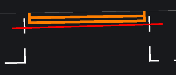

BIGAL Posted October 15, 2024 Posted October 15, 2024 What about this idea dragging a line over pairs, you can do more than one pairs say select a lot in one go. See red line in image. Quote
