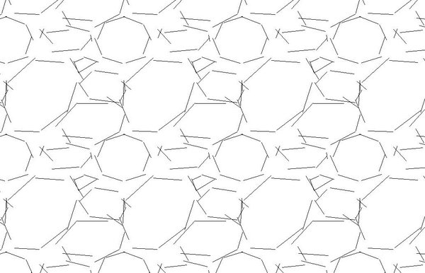

When I hatch the option "Gravel," rather than showing lots lof nice boulders I get an array of lines, roughly in the shape of boulders!
I've attached a picture to show what I mean!
Is anyone aware of how to solve this problem?

This usually happens when your hatch pattern is too far away from 0,0. Type SNAPBASE at the command line and select a point close to your hatch.
Guest Alan Cullen
Fill the HATCH dialogue window in as shown below. No more problems. As explained by Cad64, this happens when the hatch is applied too far away from base point 0,0.:

Super, thanks very much for the quick reply!

type " regen " that should work too i had same as you problem
