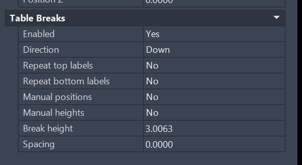

In a different existing table with the exact same table style as above, I want to add a row
I get this as a result
There are no line breaks in the properties
Can someone tell me how to make the existing table style "work" correctly?
Please tell me what is happening here please?
A guess check these 2 properties, I used dumpit.lsp to see the properties. Like wise can set say Breaksenabled using VL.
;   BreakSpacing = 0.99
;   BreaksEnabled = 0
The image I posted above was what Propertied displayed yesterday.
I made a copy and when I checked the properties, it was Table breaks. <Thanks!>
Not sure why it did not show up in the original drawing..
