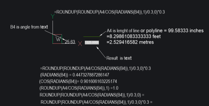

HungTran Posted Tuesday at 09:08 AM Share Posted Tuesday at 09:08 AM I'm new to AutoLISP and trying to improve my workflow. I'm stuck on this particular problem, and I need help converting an Excel formula into AutoLISP. Here's what I'm trying to do: Get the length A of an object (in mm). Divide A by the Cos of B (B is a decimal number extracted from a text object). Let's call the result C. Round C up to the nearest 0.3, then divide it by 0.3. The final result should be in meters with one decimal place. Also, in dwg file i tried field but can't write rounding function and also can't select object flexibly. LFF.lsp Test.dwg Quote Link to comment Share on other sites More sharing options...

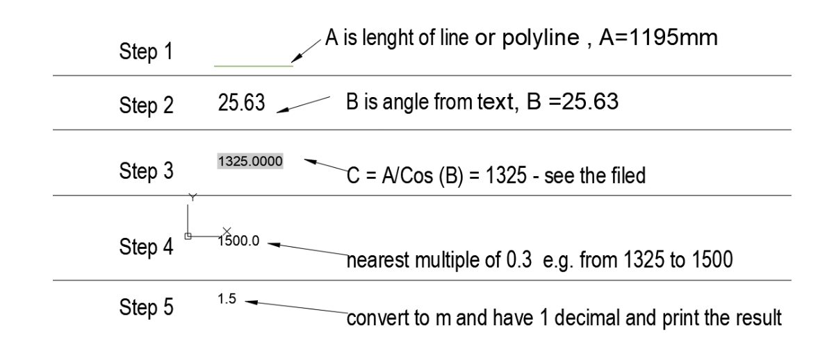

HungTran Posted Thursday at 02:35 AM Author Share Posted Thursday at 02:35 AM 2 hours ago, BIGAL said: I found that using 0.3 the roundup by Lee does not seem to give correct answer, if .3 .6 .9 is desired result. Maybe Lee will comment. Can you confirm that is the values you want, I did a cond at one stage that would return those fractions for any number. I am confused by what your trying to do. Can you fill in the last 2 values please for the attached dwg. Test2.dwg 42.27 kB · 0 downloads @BIGAL thank you. i realized the error in the excel structure. not suitable to describe for autocad. i rewrote the order of steps for autocad. hope you understand. i also adjusted the lisp it works but can not print the result. Let see picture and attached NewCode.dwg 1 hour ago, lrm said: @HungTran It is not clear what you mean by "...Round C up to the nearest 0.3". If that means, for example, that 5.2 --> 5.3 and 4.45 --> 5.3 then the following will work for you. (defun c:r3 (/ a b c) (setq a (getreal "\nEnter number: ")) (setq b (rem a 1)) (if (> b 0.3) (setq c (+ 1.3 (- a b))) (setq c (+ 0.3 (- a b))) ) (princ c) (princ) ) @Irm I mean the nearest multiple of 0.3 e.g. 1.325 to 1.5. That number divisible by 0.3 results in an integer NewCode.dwg Quote Link to comment Share on other sites More sharing options...

lrm Posted Thursday at 02:58 PM Share Posted Thursday at 02:58 PM @HungTran What should happen if the lenght divided by 0.3 is an interger? E.g., should 1.5 stay at 1.5 or round up to 1.8? Quote Link to comment Share on other sites More sharing options...
