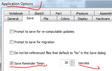

I'm not sure what's up, but mine keeps crashing, too. I'll get really far into a drawing and then it'll just freeze on me... Is there a way to make the program autosave like every 5-10 minutes?
  StykFacE said:
Amen, brutha. Personally, I hit CTRL+S about every 30 seconds. I don't even think about it, it's just comes as second nature to me now, and everyone should be that way, especially in CAD design. 8)
Yeah, that's probably my problem... I'm so used to AutoCAD 3D autosaving, and recently switched to Inventor, so I still rely on the computer to autosave... big mistake on my part, as I just lost a drawing that took me hours.
Tools>Application Options and set Save reminder
Thanks, JD.
