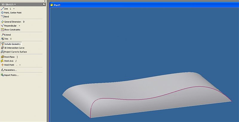

shift1313 Posted March 6, 2009 Posted March 6, 2009 Wow this thread spans a good bit of time:) I started using Autocad back in 95 or so in high school. In college in 99 in freshmen engineering class we were introduced to Mechanical Desktop(which they taught as autocad). It wasnt until work got a copy of inventor 10 for me that I even had anything to do with it. Instanly I was engulfed in it. I tried to just "pick it up" but thats not a very good idea:) I went through as many tutorials as I could but here at works there isnt really "training" its do it and get done most of the time. I did have a senior cad design class using unigraphics and once i was introduced to that, no turning back. I still do use autocad(05 07 and 09) on a regular basis but for what I do these other packages are just great. I think out of all of the packages I really enjoy Solidworks. Inventor is great, and Unigraphics is very powerful and I find myself modeling things in there and bringing them into SW at times. Using software incorrectly can be very frustrating. Once you have the insight into what can be done and how it should be done, there is a world of difference. I still really havent had "training" and im still learning every day, mostly through this forum. As for explode, You can start a 3d sketch and use project geometry, include geometry, 3d intersection curve and project curve to surface. In this case(at least what it sounds like) a 3d sketch with include geometry is what you want to extract edges. Here is a screen shot i just did in IV11 pro. I did an extrusion with an arc in one direction, then i drew a spline curve in the other and kept the intersection between the two so i would have a complex edge and used the include geometry(purple). Now you cant modify this line(or at least i dont think so) but you can use it which is what you would do with exploded geometry. Quote
JD Mather Posted March 6, 2009 Posted March 6, 2009 shift1313 said: Now you cant modify this line(or at least i dont think so)... RMB Break Link Quote
