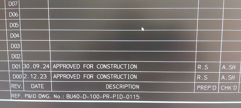

mehrdad Posted Monday at 12:34 PM Author Share Posted Monday at 12:34 PM Greetings to you, hosneyalaa. Thank you for your cooperation. I would like the "30.09.24 APPROVED FOR CONSTRUCTION" and its continuation to be produced in the other drawings that are in a folder, as they do not currently exist. Quote Link to comment Share on other sites More sharing options...

mehrdad Posted Monday at 03:56 PM Author Share Posted Monday at 03:56 PM (edited) Thank you very much for your follow-up. Yes, I understand. I am attaching a CAD file, and in row D1 under DESCRIPTION, if possible, I would like to be able to write any necessary words in PREP'D, CHK'D, APP'D based on the project requirements. 10-HFG1600631001-G01-N_Sht_1.dwg Edited Monday at 04:00 PM by mehrdad Quote Link to comment Share on other sites More sharing options...

mehrdad Posted Tuesday at 04:29 AM Author Share Posted Tuesday at 04:29 AM Hello BIGAL, thank you for your response. However, since my knowledge of Lisp is very limited, unfortunately, I didn’t quite understand. What I want is, if possible, that as soon as I open a new drawing, or in any way that is feasible, all the new information such as the date, descriptions, producer, and verifier are entered in row D01. Thank you again for your help! Quote Link to comment Share on other sites More sharing options...
rlx Posted Tuesday at 05:15 AM Share Posted Tuesday at 05:15 AM try this : ;;; rlx 2024-10-01 - https://www.cadtutor.net/forum/topic/91692-request-for-assistance-in-editing-texts/ (defun c:Mehrdad ( / doc actLay actDoc actDocs actApp actDbx AllOpen dir lst x-list y-list y z save) (vl-load-com) (setq x-list (list 252.0 280.0 360.0 375.0 388.0) y-list (list 26.5 33.0 39.5 46.0 52.5 59.0 65.5) z 0.0) (setq s-list (list (now) "APPROVED FOR CONSTRUCTION" "R.S" "A.SH" "RLX")) ;;; set y coordinate for row D1 (setq y (nth 1 y-list)) (if (and (setq dir (GetShellFolder "Select Folder")) (vl-consp (setq lst (alldrawings dir)))) (foreach dwg lst (if (setq doc (odbx_open dwg)) (progn (mapcar '(lambda (txt x) (addtext_dbx doc txt (list x y z) 3.125)) s-list x-list) (if (vl-catch-all-error-p (setq save (vl-catch-all-apply 'vla-saveas (list doc dwg)))) (alert (strcat "Save error: " (vl-catch-all-error-message save) "\ndrawing : " (vl-princ-to-string dwg)))) ) (princ (strcat "\nUnable to open : " dwg)) ) ) ) (_ReleaseAll) (princ "\nDone.") (princ) ) ;;; --- Odbx ---------------------------------------------- Begin Odbx Section ----------------------------------------------- Odbx --- ;;; (defun GetAllOpenDocs () (or actApp (setq actApp (vlax-get-acad-object))) (or actDoc (setq actDoc (vla-get-ActiveDocument actApp))) (or actDocs (setq actDocs (vla-get-documents actApp))) (vlax-for doc actDocs (if (= 1 (vlax-variant-value (vla-getvariable doc "DWGTITLED"))); no nameless drawings (setq AllOpen (cons (cons (strcase (vla-get-fullname doc)) doc) AllOpen)))) ) (defun _ReleaseAll () (mapcar '(lambda(x) (if (and (= 'vla-object (type x)) (not (vlax-object-released-p x))) (vlax-release-object x))(set x nil)) (list 'doc 'actLay 'actDoc 'actDocs 'actApp 'actDbx))(gc)) (defun _InitObjectDBX ()(or actApp (setq actApp (vlax-get-acad-object))) (or actDoc (setq actDoc (vla-get-ActiveDocument actApp)))(or AllOpen (setq AllOpen (GetAllOpenDocs))) (setq actDbx (vl-catch-all-apply 'vla-getinterfaceobject (list actApp (dbx_ver)))) (if (or (null actDbx)(vl-catch-all-error-p actDbx))(progn (princ "\nObjectDbx not available")(setq actDbx nil))) actDbx ) (defun odbx_open ( $dwg / _pimp doc) (or AllOpen (GetAllOpenDocs)) (defun _pimp (s) (strcase (vl-string-trim " ;\\" (vl-string-translate "/" "\\" s)))) (cond ((or (void $dwg) (not (findfile $dwg)))(princ "\nInvalid drawing")(setq doc nil)) ((not (or actDbx (_InitObjectDBX)))(princ "\nObjectDbx not available")(setq doc nil)) ((setq doc (cdr (assoc (_pimp $dwg) AllOpen)))) ((vl-catch-all-error-p (vl-catch-all-apply 'vla-Open (list actDbx (findfile $dwg)))) (princ "\nUnable to open drawing.")(setq doc nil)) (t (setq doc actDbx))) doc ) (defun odbx_close ( %doc ) (if (and (= 'vla-object (type %doc)) (not (vlax-object-released-p %doc)))(progn (vlax-release-object %doc))(setq %doc nil))) (defun dbx_ver ( / v) (strcat "objectdbx.axdbdocument" (if (< (setq v (atoi (getvar 'acadver))) 16) "" (strcat "." (itoa v))))) ;;; --- Odbx ---------------------------------------------- End Odbx Section ------------------------------------------------- Odbx --- ;;; ;;; --- Tiny Lisp ---------------------------------------- Begin of Tiny Lisp ------------------------------------------- Tiny Lisp --- ;;; ; generic getfolder routine with possibility to create a new subfolder (GetShellFolder "select path") (defun GetShellFolder ( m / f s) (if (and (setq s (vlax-create-object "Shell.Application")) (setq f (vlax-invoke s 'browseforfolder 0 m 65536 "")))(setq f (vlax-get-property (vlax-get-property f 'self) 'path)) (setq f nil))(vl-catch-all-apply 'vlax-release-object (list s)) (if f (strcat (vl-string-right-trim "\\" (vl-string-translate "/" "\\" f)) "\\"))) ;;; (getsubfolders "c:/temp/lisp") (defun getsubfolders ( d / l r s )(setq d (Dos_Path d))(setq l (list (vl-string-trim "/\\" d)))(while l (setq s nil) (foreach d l (setq s (append s (mapcar (function (lambda (x)(strcat d "\\" x))) (vl-remove-if (function (lambda (x)(member x '("." ".."))))(vl-directory-files d nil -1)))))) (setq r (append s r) l s)) (cons d (mapcar 'Dos_Path r)) ) (defun Dos_Path ($p) (if (= (type $p) 'STR) (strcase (strcat (vl-string-right-trim "\\" (vl-string-translate "/" "\\" $p)) "\\")) "")) (defun alldrawings ( d / s l r) (setq l (mapcar 'Dos_Path (getsubfolders d))) (foreach s l (setq r (append r (mapcar '(lambda (x)(strcat s x))(vl-directory-files s "*.dwg" 1))))) r) ;;; s = string , p = insertion point , h = text height (defun addtext_dbx (d s p h / o a) (setq o (vla-AddText (vla-get-ModelSpace d) s (vlax-3d-point p) h))) (defun now ( / ns) (setq ns (rtos (getvar "CDATE")) ns (strcat (substr ns 7 2) "-" (substr ns 5 2) "-" (substr ns 1 4)))) ;;; --- Tiny Lisp ---------------------------------------- Begin of Tiny Lisp ------------------------------------------- Tiny Lisp --- ;;; (c:Mehrdad) I'm still very busy , so chances are I won't be able to handle any snowball' requests ('thanx , but could you also....') so I disabled all notifications from cad-tutor for now. Quote Link to comment Share on other sites More sharing options...

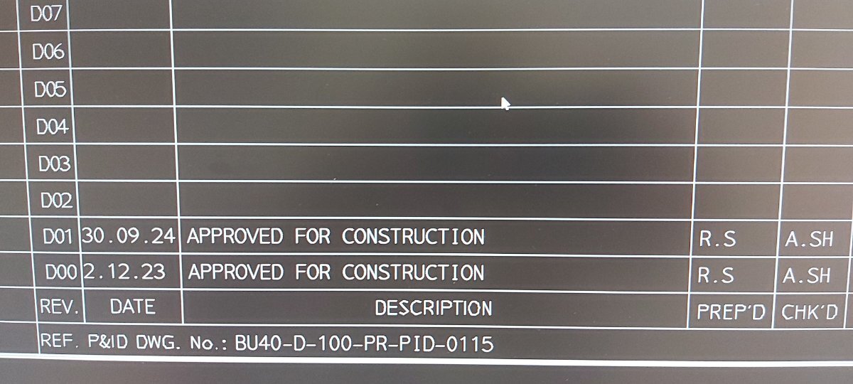

rlx Posted Tuesday at 06:44 AM Share Posted Tuesday at 06:44 AM I ran it without any probems , just saved your drawing 3 times for testing oh darn , the void thing , I checked if I used it here but guess I overlooked it , my bad : (defun void (x) (or (eq x nil) (and (listp x)(not (vl-consp x))) (and (eq 'STR (type x)) (eq "" (vl-string-trim " \t\r\n" x))))) you may want to change line 5 , the line with s-list , didn't know who APP'd it so I used "RLX" but you probably wish to put another name here 1 Quote Link to comment Share on other sites More sharing options...
mehrdad Posted Tuesday at 07:36 AM Author Share Posted Tuesday at 07:36 AM Greetings to rlx, I am very grateful to you for writing this program, which has significantly reduced my work time, and this is highly appreciated. However, I have a question: Considering that the date may not always be the current date, is it possible for the date to be written in the program and then entered like before? Also, instead of the date format being 01-10-2024, could it be written as 01-10-24? Thank you once again. Quote Link to comment Share on other sites More sharing options...

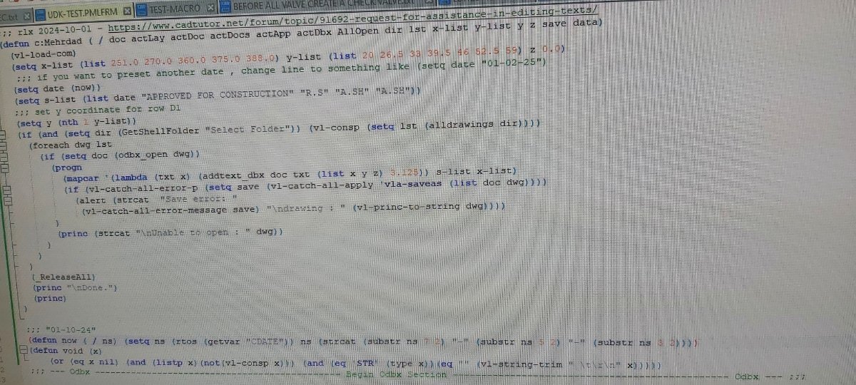

rlx Posted Tuesday at 07:54 AM Share Posted Tuesday at 07:54 AM (defun c:Mehrdad ( / doc actLay actDoc actDocs actApp actDbx AllOpen dir lst x-list y-list y z save data) (vl-load-com) (setq x-list (list 252.0 280.0 360.0 375.0 388.0) y-list (list 26.5 33.0 39.5 46.0 52.5 59.0 65.5) z 0.0) ;;; if you want to preset another date , change line to something like (setq date "01-02-25") (setq date (now)) (setq s-list (list date "APPROVED FOR CONSTRUCTION" "R.S" "A.SH" "A.SH")) ;;; set y coordinate for row D1 (setq y (nth 1 y-list)) (if (and (setq dir (GetShellFolder "Select Folder")) (vl-consp (setq lst (alldrawings dir)))) (foreach dwg lst (if (setq doc (odbx_open dwg)) (progn (mapcar '(lambda (txt x) (addtext_dbx doc txt (list x y z) 3.125)) s-list x-list) (if (vl-catch-all-error-p (setq save (vl-catch-all-apply 'vla-saveas (list doc dwg)))) (alert (strcat "Save error: " (vl-catch-all-error-message save) "\ndrawing : " (vl-princ-to-string dwg)))) ) (princ (strcat "\nUnable to open : " dwg)) ) ) ) (_ReleaseAll) (princ "\nDone.") (princ) ) ;;; "01-10-24" (defun now ( / ns) (setq ns (rtos (getvar "CDATE")) ns (strcat (substr ns 7 2) "-" (substr ns 5 2) "-" (substr ns 3 2)))) 1 Quote Link to comment Share on other sites More sharing options...

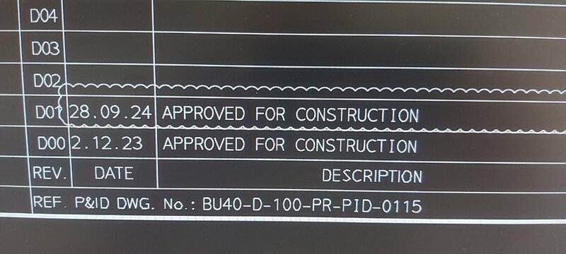

mehrdad Posted Tuesday at 10:09 AM Author Share Posted Tuesday at 10:09 AM Unfortunately, it's still displaying the date as 01-10-2024 unless I'm mistaken. Additionally, I'd like to request using the text style HTX1, as there are significant visual differences in the fonts. To ensure the program is copied correctly, is it possible to save it as a separate file or copy the entire file here so we can reach a conclusion? Thank you once again for your cooperation. I can only send a screenshot from the program due to company restrictions on file shar ing. Quote Link to comment Share on other sites More sharing options...
Steven P Posted Tuesday at 10:24 AM Share Posted Tuesday at 10:24 AM (edited) RLX code (he is busy so will drop a couple of hints, maybe you can try till he is free): Date is controlled by (getvar "CDATE") line, change the delimitator "-" to what you prefer - should be easy to spot? If you don't want todays date there is a comment in his code to change '(DATE)' to for example "01-02-25". Text style I think will be the current style, so you might want to change adding something like this .... (if (setq doc (odbx_open dwg)) (progn ;;add these lines (setq Old_Font (getvar 'textstyle) ) (setvar 'textstyle "HTX1") .... do stuff (setvar 'textstyle Old_Font) ) (princ (strcat "\nU.... also added an alternative above - in LISP there are many ways to do something, mine you will need to run along with something like Scriptwriter which is a handy LISP to have in your library. Edited Tuesday at 10:32 AM by Steven P Quote Link to comment Share on other sites More sharing options...

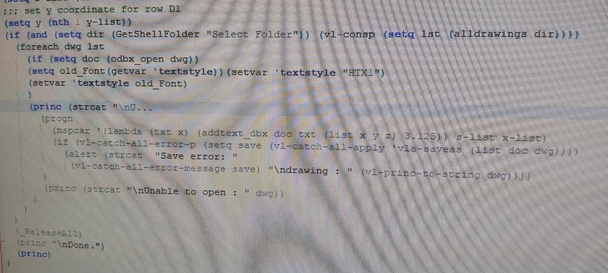

mehrdad Posted Tuesday at 10:48 AM Author Share Posted Tuesday at 10:48 AM Hello and thank you. I added this line: 'I'll attach an image,' but it still doesn't correct the date or use the HTX1 text style. Could you please send me the file directly to avoid any mistakes? I would be very grateful for your help. Quote Link to comment Share on other sites More sharing options...
Steven P Posted Tuesday at 11:09 AM Share Posted Tuesday at 11:09 AM (edited) The font section needs to go after the (progn line - looks like you have added it before the (progn line. '... do stuff is the RLX code ..... (if (setq doc (odbx_open dwg)) (progn ;;add these lines (setq Old_Font (getvar 'textstyle) ) (setvar 'textstyle "HTX1") (mapcar '(lambda (txt x) (addtext_dbx doc txt (list x y z) 3.125)) s-list x-list) (if (vl-catch-all-error-p (setq save (vl-catch-all-apply 'vla-saveas (list doc dwg)))) (alert (strcat "Save error: " (vl-catch-all-error-message save) "\ndrawing : " (vl-princ-to-string dwg)))) (setvar 'textstyle Old_Font) ) (princ (strcat "\nUnable to open : " dwg)) ) ..... Text string, as described above look through RLX code to see where it says to change it.. have a go. EDIT: Just checking this, for batch lisp you might also need to confirm you are in the right view, paperspace or modelspace - I'd usually draw in modelspace and include the borders in paperspace (makes some automation easier that way) and that the required font style is loaded into the drawing. If you will always be in model space and always have that font loaded then no worries. RLX Code appears to work OK for me as described above. Edited Tuesday at 11:31 AM by Steven P Quote Link to comment Share on other sites More sharing options...
