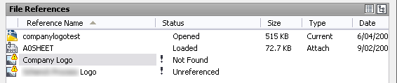

I tried that, but nothing. I can't see where I'm going wrong though, because it doesn't return an error either. It just does nothing, with or without all caps.
I tested with a Company Logo.bmp that I inserted, and then deleted the file, which works fine when I run the routine.
The only difference I see is the status: Not Found vs Unreferenced for the file I'm actually trying to detach.

I still can not get the image detach routine to work though, but I have an idea where the problem is.
If I detach via the command line manually, detaching works fine whether the status is Not Found or Unreferenced. For the lisp routine however, it does not work for Unreferenced images.
I tested it in several ways, and when I have a Not Found reference the routine detaches it just fine, no matter what name and how many words, as you said.
If I create an Unreferenced image though, it will not work.
Now the question is, what is it about the lisp routine that makes the end result different to what I can do manually from the command line? I mean, really all the routine does is check if that exact image name is there before feeding it to the command line with the image detach command.
The routine works just fine on this. Now delete the reference you can see in modelspace, it becomes Unreferenced, and the routine no longer works.
