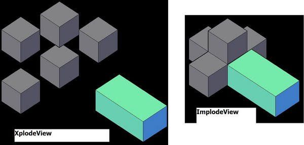

riga Posted December 3, 2007 Share Posted December 3, 2007 Good idea riga. This could probably be done with Visibility parameters and/or Lookups. There is a recent post in the General section with a location for some video tutorials on Dynamic Blocks. Dynamic Block Help I tought it was possible to do ot with polar strech action, but for a presentation the idea of visibility/lookups parameters could work better and it's easyer to do (depending on the numbers of objects that needs to be "exploded"). At this point I think it will be usefull to have a couple of images that represent which is the effect sloman needs to obtain, so that we can suggest at least a good enough work around Quote Link to comment Share on other sites More sharing options...

SLW210 Posted December 3, 2007 Share Posted December 3, 2007 Drop this in an open drawing and see what you think. Just a quick little Dynamic Block I stuck together and I am a rookie when it comes to Dynamic Blocks. Quote Link to comment Share on other sites More sharing options...

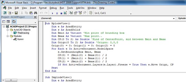

Raggi_Thor Posted December 4, 2007 Share Posted December 4, 2007 This may work for you, but if youe have many parts you should make a copy on a frozen layer and then ExplodeView Sub XplodeView() Dim e As AcadEntity Dim s As AcadSolid Dim Bmin As Variant 'Min point of bounding box Dim Bmax As Variant 'Max point.. Dim CP(0 To 2) As Double 'Kind of CenterPoint, mid between Bmin and Bmax Dim Origo(0 To 2) As Double 'Origon: 0,0,0 Origo(0) = 0: Origo(1) = 0: Origo(2) = 0 For Each e In ActiveDocument.ModelSpace e.GetBoundingBox Bmin, Bmax CP(0) = (Bmin(0) + Bmax(0)) / 2 CP(1) = (Bmin(1) + Bmax(1)) / 2 CP(2) = (Bmin(2) + Bmax(2)) / 2 If Not ActiveDocument.Layers(e.Layer).Freeze = True Then e.Move Origo, CP Next End Sub Sub ImplodeView() Dim e As AcadEntity Dim s As AcadSolid Dim Bmin As Variant 'Min point of bounding box Dim Bmax As Variant 'Max point.. Dim CP(0 To 2) As Double 'Kind of CenterPoint, mid between Bmin and Bmax Dim Origo(0 To 2) As Double 'Origon: 0,0,0 Origo(0) = 0: Origo(1) = 0: Origo(2) = 0 For Each e In ActiveDocument.ModelSpace e.GetBoundingBox Bmin, Bmax CP(0) = (Bmin(0) + Bmax(0)) / 4 'Now this is midway between CP and Origion.. CP(1) = (Bmin(1) + Bmax(1)) / 4 CP(2) = (Bmin(2) + Bmax(2)) / 4 If Not ActiveDocument.Layers(e.Layer).Freeze = True Then e.Move CP, Origo Next End Sub Quote Link to comment Share on other sites More sharing options...

Raggi_Thor Posted December 11, 2007 Share Posted December 11, 2007 I tested with both solids and surfaces. There is no error control in my code it's just a fast example, it may not work in all drawings, but it worked in a few I tested. Press ALT+F11 to open the VBA editor in AutoCAD (or use menu Tools / Macro / Visual Basic Editor) Paste the code from above, see image belowe. Then use the command VBARUN or make two command buttons, with macros like ^C^C-vbarun;XplodeView and ^C^C-vbarun;ImplodeView Quote Link to comment Share on other sites More sharing options...
sloman Posted December 11, 2007 Author Share Posted December 11, 2007 Actually i must say these works like a charm. Great job really posting these. When i explode a small disortion is presented for some solids (minimum displacement for parts). I guess beacose of mid point and distance frome it. But for presentation purposes these is yust the best. How could i create buttons as you suggested? A command Vbarun works like a charm, but i like to try it with a button to. Edit: I have created a button in customize and add ^C^C-vbarun;XplodeView ... and again it works like a charm. Thanx x 2 Quote Link to comment Share on other sites More sharing options...
