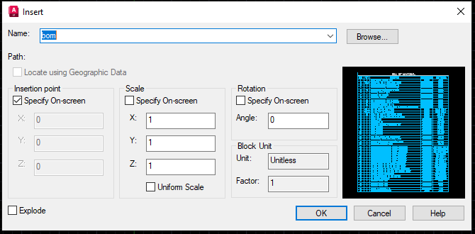

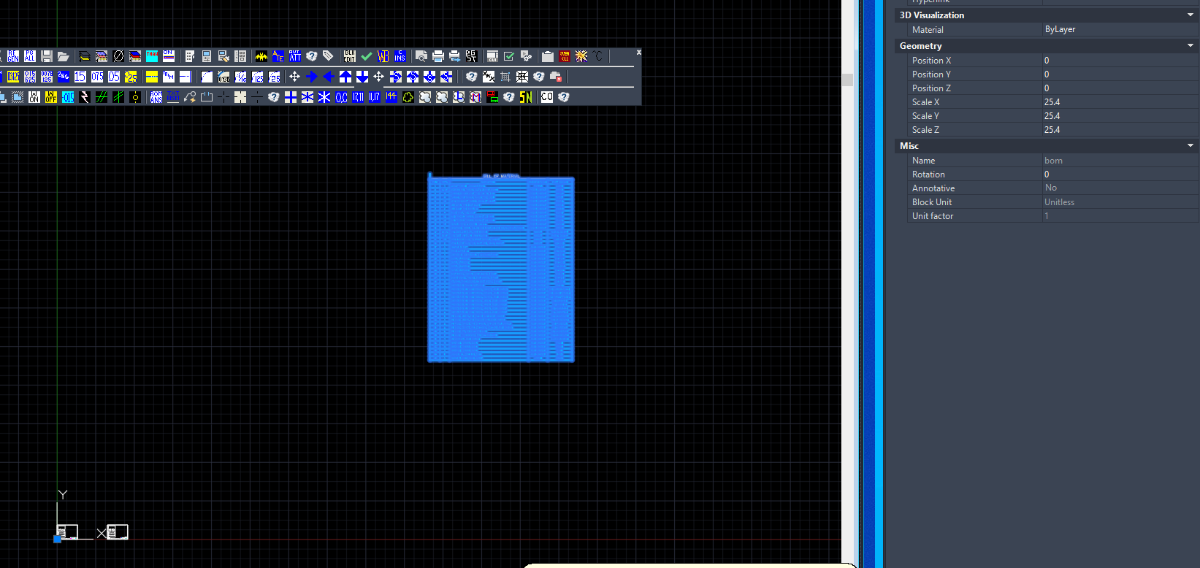

Does anyone know why my block comes in at a scale of 25.4 even though I insert it at a scale of 1?
Did not answer previously but a block from another dwg needs same drawing units eg mm v's Feet will give a scale factor of 1/0.3048
Check your UNITS command in both drawings. We fixed up our blocks and had them in a dwt as suggested by @ReMark
