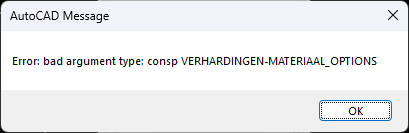

But gives this error:
The name VERHARDINGEN-MATERIAAL_OPTIONS is EXACTLY the same result as the first 'hard-coded' example...
so.... why does it give a error with a dynamic code... but works when it is hardcoded?

Consp generally means that the argument isn't a list.
Have a test and use (type Verhardingen-Verband_options) in a princ or alert line to show what Verhardingen-Verband_options is. Let us know if it is a list because there is something else wrong otherwise
Oh, for god sake.....
Sometimes you need to take a break at the right time....
I forgot to EVAL function, after the read, to actualy get the list, and not just the symbol name....
Problem solved!
