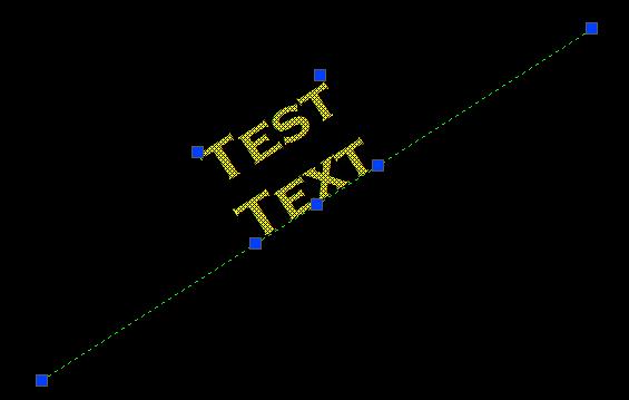

SWEET!!! :) I am having one problem though, when the mtext that has the width of 90 is placed the offset from the line has varied from one drawing to the next? Not sure what caused this, let me know what you think?
Thanks,
Stryder

The size of the textbox, and consequently the rotation and movement is determined by the variable TLINESPAC multiplied by the variable TEXTSIZE, this may vary from drawing to drawing...
hmmm.... Is there a way to make this to where it is constant just like the mtext without a width? If not I guess I will just stick to the previous code.
Hmm... try this, but I don't like it too much :(

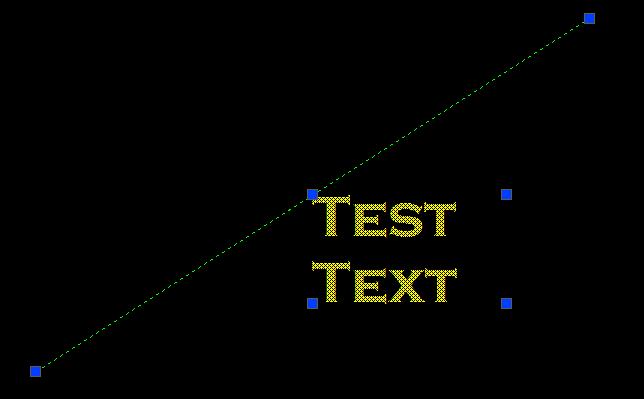

Why don't you like it? :( Strange things are happening when I use it. The distance from the line to the insertion point of the text is different for the mtext with a width than from the mtext with the width of 0. And the distance varies from drawing to drawing. Maybe in this case I am guilty of wanting a lazy-man's customization to a lisp that is AWESOME to begin with. All I have to do is click the mtext and then in properties type 90 for the width if I want it stacked, I just sort of thought you could show off some of your AMAZING skillz if it would do this automatically for us! :lol:
Thanks for the help,
Stryder
Just because I modelled it on the drawing that you posted and just measured the height of two rows of text and used that as the measurement, so it will be different for different Text Styles, Sizes etc. - I shall have another look though :thumbsup:
P.S. - Keep this up and I may get you on the payroll here!:wink:
Now that would be a treat :D

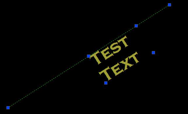

Give this a shot - if this doesn't work then I am fast running out of ideas...

:D Awesome!!! :D
It is not exactly 4 every time but it is close enough. I am not building a piano or performing spinal sugery here. :lol:

Lets assume that there is no offset and you want the text to be placed with the bottom-center point at the midpoint of the line - this will simplify our situation.
So, I first place the text. The insertion point of the MTEXT is always recognised by LISP as being the top-left-hand corner of the MTEXT, so the text is initially placed like this:
I then proceed to put the angle of the line as the rotation of the MTEXT, but this will rotate the MTEXT about the insertion point, so that it looks like this:

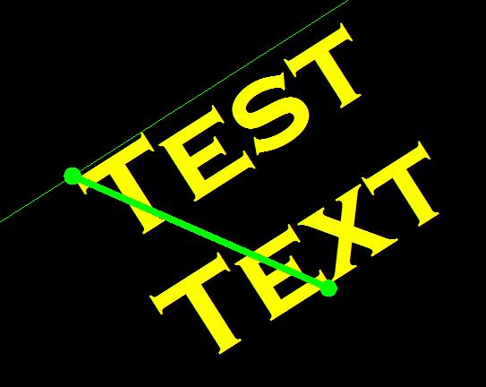

I now need to move the MTEXT so that the bottom center point is at the mid-point of the line (with our aforementioned assumption).
To do this, I find the vector that runs from the top-left-hand corner to the bottom mid point. This vector will vary with Text Size, Text Style, Rotation, and the value of the String itself.
I then move the text with a base point of the origin, by a displacement of this vector:
Hope this makes more sense. You can now see why it is more difficult to put in two lines of text. - to find the vector I use a function called "TEXTBOX" which gives the bottom-right and upper-left coordinates of the bounding box of the text, if it were to be inserted at the origin - but this does not allow for two lines of text, as line spacing now needs to be accounted for - which also varies from drawing to drawing and text style to text style - this complicates matters further.
