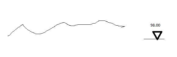

hello there,
Can anyone please provide me a lisp file that provides polyline vertices respective distance and there vertices. i have desired level at a point and it will be used as reference level for the polyline vertices. The data then need to be required to exported to excel. Please kindly help.
the data should be in
0,100
2,101
5,110
Edited by Rabindra Bhatta

@Rabindra Bhatta, please upload your sample dwg , included te block or whatever is the triangle and 98.00 , and xls sample to be used

@devitg I have attached the file. As i have many such polyline with reference level about 100. I have tried to do it manually by providing distance and level as shown in drawing. it is taking me too much time to do the work as i have to provide dimension and then level after that i have to write it manually to excel. It would be a kind  help sir, if you can provide me a lisp file to do the work.

Hi,
Try this, you can select muliples polylines for export result to Excel (I have add the handle of entitie in Excel for find in drawing)

Admin double posted.
@Tsuky I think wanted chainage of section also in data. See other post dwg.
