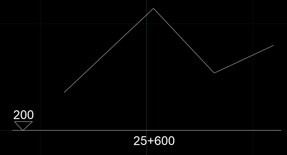

Hi guys,
I would need a lisp for exporting to csv or txt file 2d polyline vertices from a cross section based on the picks:
1. pick the chainage
2. pick the 0.0 offset line
3. pick the reference level line
4. pick the reference level elevation text
5. pick the polyline for exporting vertices
The lisp would calculate offsets and elevations comparing to picked 0.0 offset line and given reference level.
the data exported to csv/txt file would have structure like this:
chainage
offset on the left;elevation
offset on the right;elevation
for example:
25+500
-5.0;212.22
-3.0;200.50
1.1;205.69
4.6;202.37
25+600
-2.0;213.22
-3.0;201.50
5.1;205.69
6.6;202.37
25+700
-4.0;202.22
-2.0;220.50
5.1;212.69
8.6;212.3
Does anybody have a code which could be used for developing such workflow?
