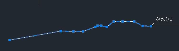

Is there any method so that we can get level and offset of a polyine?
Let us assume we have drawn a polyine in zigzag way. A level is provided at one point and we need to find the offset of polyline point and the points level and then export it to excel.
Please kindly help.
Yes is the answer as the pline has 2d points you know Y values so can work out all points including Z then send to excel.
I do direct to excel others do CSV.
Here is pline points as a start.
(setq plent (entsel "\nPick rectang"))
(if plent (setq co-ord (mapcar 'cdr (vl-remove-if-not '(lambda (x) (= (car x) 10)) (entget (car plent))))))
(princ co-ord)
On holidays so limited time may  be later or some one else will jump in.
Excel defuns you can use to open Excel and put cell values.
Alan Excel library.lspFetching info...

I have a level mentioned and have to export the distance of points in polyline with its level to excel. No any coordinates are required.
Please kindly help with the problem.
The Alan excel.lsp is not a program that you load rather it contains multiple functions that you use in your own code like Putcell. I have limited time at moment someone else may jump in.
