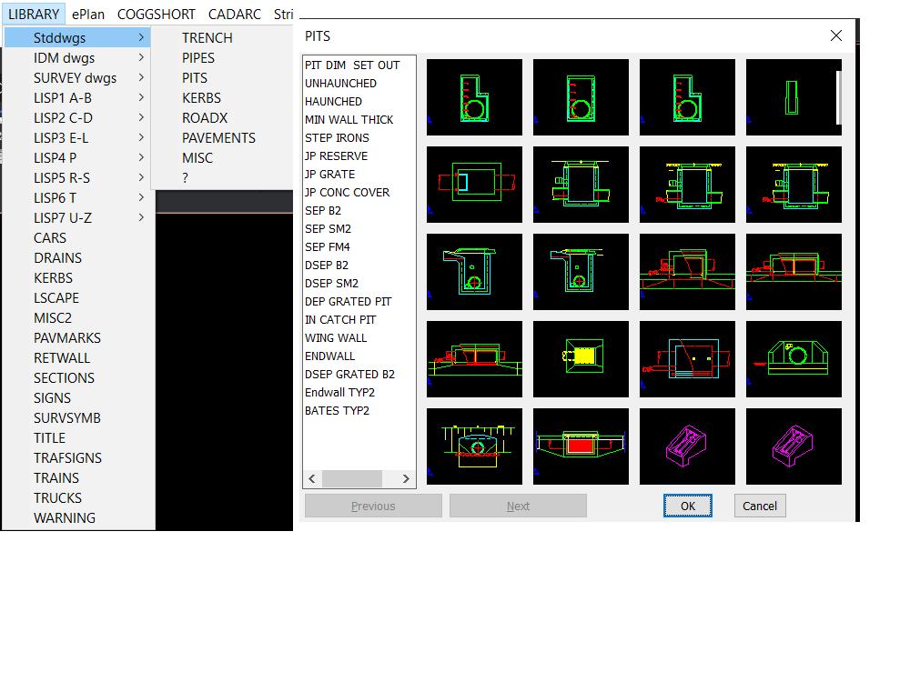

BIGAL Posted September 22, 2024 Posted September 22, 2024 (edited) Ok that is not a toolbar, you have to be old like me, its a screen menu may be wrong name. It was very useful can have sub menu's etc it was a nice option but disappeared, you could click on an option like walls and it would open a submenu with wall sizes and so on. Its very old trying to find an old mnu for you, it was called in a mnu by using $S option, $I is image. You had mnu sections that match the say $S=BL Begin AutoCAD Screen Menus ***SCREEN **S [AutoCAD]^C^C^P(ai_rootmenus) ^P [* * * *]$S=OSNAPB [ASE:]^C^C^P(ai_aseinit) ^P [BLOCKS]$S=X $S=BL [DIM:]^C^C$S=X $S=DIM0 _DIM [DISPLAY]$S=X $S=DS [DRAW]$S=X $S=DR [EDIT]$S=X $S=ED [INQUIRY]$S=X $S=INQ [LAYER...]^C^C_DDLMODES [MODELER]$S=X $S=SOLIDS [MVIEW]$S=MVIEW [PLOT...]^C^C_PLOT [RENDER]$S=X $S=RENDER [SETTINGS]$S=X $S=SET [SURFACES]$S=X $S=3D [UCS:]^C^C_UCS [UTILITY]$S=X $S=UT [SAVE:]^C^C_QSAVE This was a sub menu contained within you menu. mnu file. **SET_SC 2 [SCALES: ] [ 1:1 ]1 [ 1:2 ]2 [ 1:5 ]5 [ 1:10 ]10 [ 1:20 ]20 [ 1:25 ]25 [ 1:50 ]50 [ 1:100 ]100 [ 1:200 ]200 [ 1:250 ]250 [ 1:500 ]500 [ 1:1000]1000 Found the calling command. (menucmd "S=SET_SC") This was like 30 years ago so a bit hard to remember how to do it. Maybe something like this has around 130 lisps behind it. Edited September 22, 2024 by BIGAL 1 Quote
