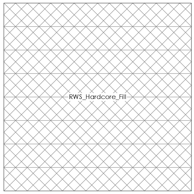

3dwannab Posted September 19, 2024 Posted September 19, 2024 Hardcore fill is generally compacted in 150mm layers. I wanted to create a hatch to represent this with diagonal lines in a cross pattern along with a horizontal line to represent the layers. I have the hatch working but I was curious to learn if that value for delta-y is 0.35355339? I would of thought it would be one. Or is there some mathematics involved here? RWS_Hardcore_Fill.pat Quote

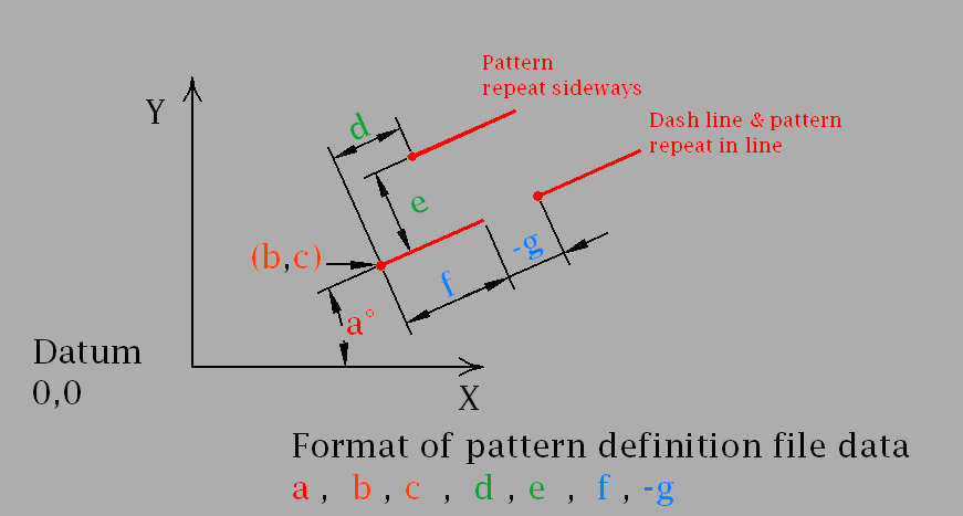

eldon Posted September 20, 2024 Posted September 20, 2024 10 hours ago, 3dwannab said: ................ I would of thought it would be one. Or is there some mathematics involved here? The mathematics are (Square root of 2) divided by 4. It is the perpendicular distance between the 45 degree lines, based on the horizontal lines being 1 unit apart. Delta-y is always measured perpendicular to the line being defined. Perhaps my diagram of the pattern data may help. The delta-y is labelled "e" 1 Quote
eldon Posted September 20, 2024 Posted September 20, 2024 If you had wanted the delta-y of the second two lines to be 1, then the delta-y of the 0 angle line would have to be (4 divided by the square root of 2) instead of 1. 1 Quote
