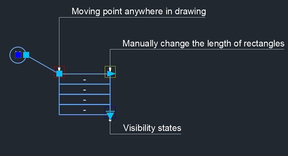

Saxlle Posted September 23, 2024 Posted September 23, 2024 (edited) Hi @smitaranjan, Try this LISP which i made and use "DYNAMIC_BLOCK.dwg" to insert a BLOCK with ATTRIBUTES into the drawing. The MAX number of TEXT or MTEXT that can be placed within each ATTRIBUTE is 1 (total number of ATTRIBUTE is 4). Also, if your selection set of TEXT or MTEXT is greater than 4, you will receive a message in the command line with a list of values from the selection set whose list length is greater than 4. Inside TBA.lsp you will find other information about how lisp works. Try to save a "DYNAMIC_BLOCK.dwg" and TBA.lsp in folder anywhere on disk partition, it will be much easier. See a picture which hold a descriptions for "grips". Feel free to provide comments about TBA.lsp. Best regards. TBA.lsp DYNAMIC_BLOCK.dwg Edited September 24, 2024 by Saxlle 1 Quote

Saxlle Posted September 24, 2024 Posted September 24, 2024 @smitaranjan This is how TBA lisp works. See the attached video. You don't need to manually copy and paste TEXT or MTEXT inside of block! After selection set is finished you just need to pick a point where to insert block one by one. If this fit for your needs, use it. Best regards. TBA.mp4 2 Quote
