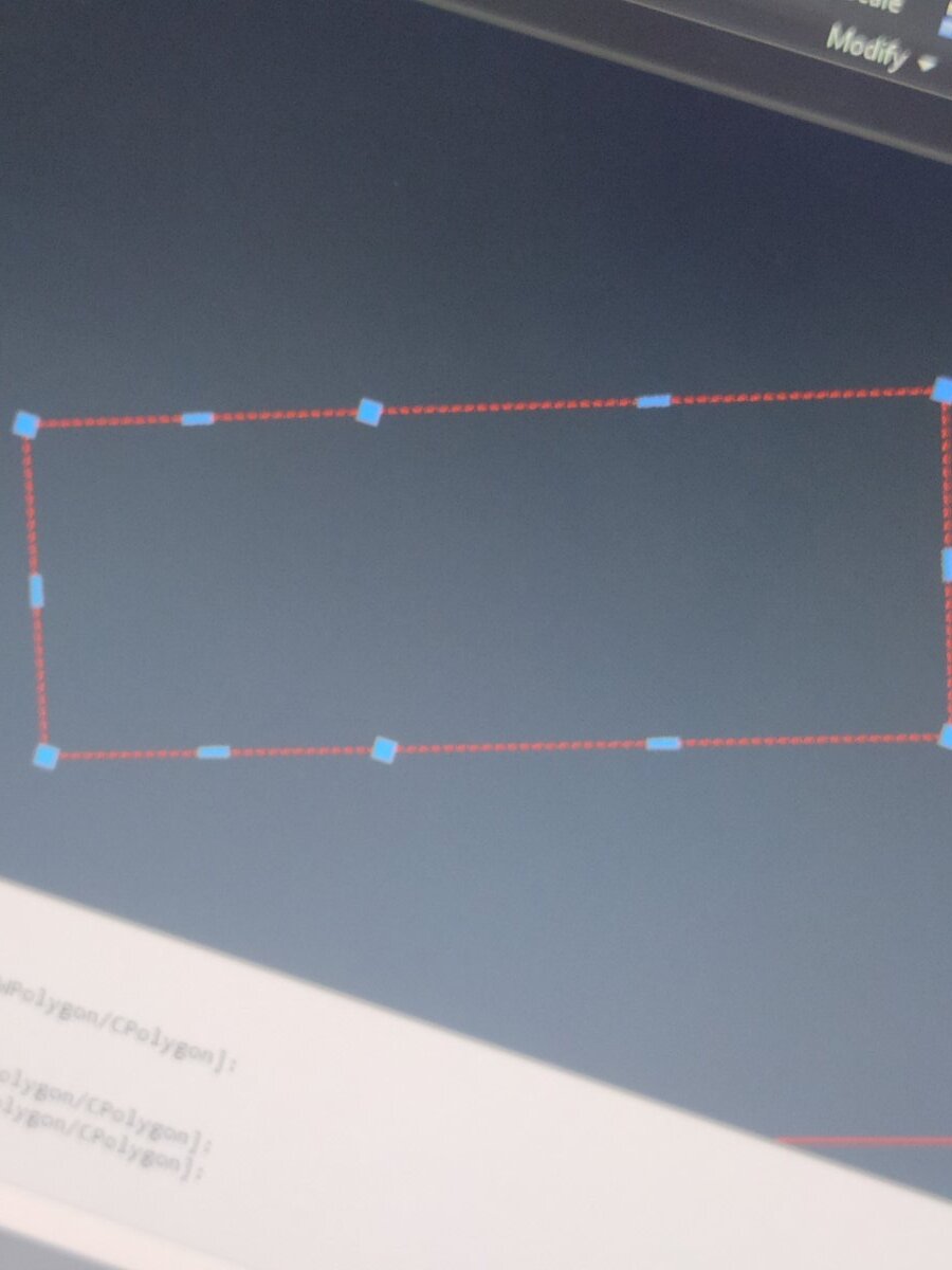

Akanezuko Posted September 18, 2024 Posted September 18, 2024 I need a lisp file where I can get corner points of a polygon instead of whole vertices. Quote
Isaac26a Posted September 18, 2024 Posted September 18, 2024 Could you explain what you mean for corner points, is ti like bounding box?, Maybe a graphic illustration would help. 1 Quote

Akanezuko Posted September 19, 2024 Author Posted September 19, 2024 7 hours ago, Lee Mac said: Assuming rectangular bounding box for LWPolyline - (defun polybb ( ent ) ( (lambda ( lst ) (mapcar '(lambda ( x ) (apply 'mapcar (cons x lst))) '(min max))) (mapcar 'cdr (vl-remove-if-not '(lambda ( x ) (= 10 (car x))) (entget ent))) ) ) Usage: (defun c:test ( / sel ) (cond ( (not (setq sel (car (entsel))))) ( (/= "LWPOLYLINE" (cdr (assoc 0 (entget sel)))) (princ "\nObject is not an LWPolyline.") ) ( (foreach x (polybb sel) (entmake (list '(0 . "POINT") (cons 10 (trans x sel 0)))) ) ) ) (princ) ) Thank you @Lee Mac for the reply. The code you sent work like a bounding box but my requirement is to get four corners of a polygon. Quote

Lee Mac Posted September 19, 2024 Posted September 19, 2024 Here's another approach - (defun c:test ( / elv ent enx ) (cond ( (not (setq ent (car (entsel))))) ( (/= "LWPOLYLINE" (cdr (assoc 0 (setq enx (entget ent))))) (princ "\nObject is not a polyline.") ) ( t (setq elv (list (cdr (assoc 38 enx)))) (foreach x (getcorners ent) (entmake (list '(0 . "POINT") (cons 10 (trans (append x elv) ent 0)))) ) ) ) (princ) ) (defun getcorners ( ent / enx lst pnt rtn ) (setq enx (entget ent) lst (mapcar 'cdr (vl-remove-if-not '(lambda ( x ) (= 10 (car x))) enx)) ) (if (< (length lst) 3) lst (progn (setq rtn (list (cadr lst) (car lst)) lst (cddr lst) ) (while (setq pnt (car lst)) (while (and (cadr rtn) (LM:collinear-p pnt (car rtn) (cadr rtn))) (setq rtn (cdr rtn)) ) (setq rtn (cons pnt rtn) lst (cdr lst) ) ) (setq rtn (reverse rtn)) (if (and (= 1 (logand 1 (cdr (assoc 70 enx)))) (LM:collinear-p (last rtn) (car rtn) (cadr rtn)) ) (setq rtn (cdr rtn)) ) rtn ) ) ) ;; Collinear-p - Lee Mac ;; Returns T if p1,p2,p3 are collinear (defun LM:Collinear-p ( p1 p2 p3 ) ( (lambda ( a b c ) (or (equal (+ a b) c 1e-8) (equal (+ b c) a 1e-8) (equal (+ c a) b 1e-8) ) ) (distance p1 p2) (distance p2 p3) (distance p1 p3) ) ) (princ) 1 Quote
