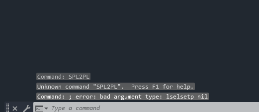

Hi @pondpepo9,
The reason why you're getting "error: bad argument type: lselsetp nil" is because "(sslength ss)" is 0, which means that when you asked to "Select a spline to convert to pline:", there is no "SPLINE" entity in the drawing. Can you post a .dwg file?
Best regards.

I get the same error and I definitely have splines in the drawing. Both AutoCAD 2024 at work and AutoCAD 2000i at home.

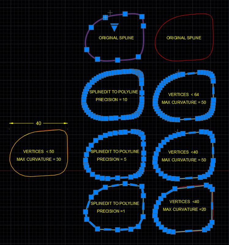

I've been experimenting with a method to give greater user control in the conversion of a 2D spline to a polyline.  The following program enables the user to specify the maximum number of vertices for the resulting polyline from a selected spline.  The program calculates the instantaneous radius of curvature for points along the spline. If the magnitude of the radius is above a specified threshold then a vertex for the polyline is not created at that point.   The image below shows the results of using the splinedit commad (left column) and the program (right column). The radius of curvature is output to aid the user in determining an appropriate threshold for successive runs of the program.
Note that the program creates vertices closer together where the spline radius is small and further apart for flatter sections of the spline.  The splines are red and polylines yellow in the image below.
