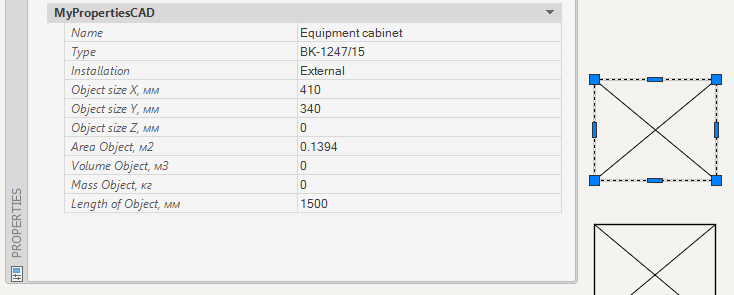

maratovich Posted Sunday at 06:56 PM Share Posted Sunday at 06:56 PM Is this suitable? Located here - MyPropertiesCAD 1 Quote Link to comment Share on other sites More sharing options...
shadashiindia Posted Thursday at 05:07 PM Author Share Posted Thursday at 05:07 PM On 9/15/2024 at 10:56 PM, maratovich said: Is this suitable? Located here - MyPropertiesCAD Yes, this is what I was looking for. Thank you. Quote Link to comment Share on other sites More sharing options...
